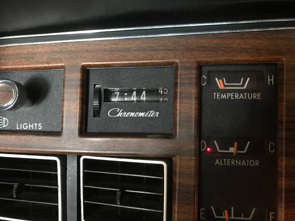

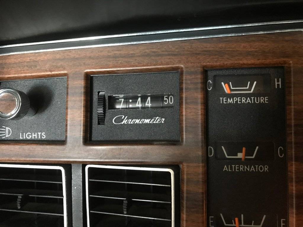

Hello !
Electric Problem on my 76er NYB.
Sometimes the charging control lamp "lights" on driving. (the little red lamp on the charging gauge)
After a couple of miles it stops "lighting" means everthing is ok.
But after a couple of miles the game is starting again. ("light on", "light off" .......)
Also possible "light" is off for 150 miles or more.
The gauge reads charge (testet on cigar lighter = 14,5V)
Battery is good (terminals tight and clean)
Alternator (100Amp) new
Electronic voltage regulator new
Ground Cables clean an tight.
any help ???
Thanks
Wolfgang
