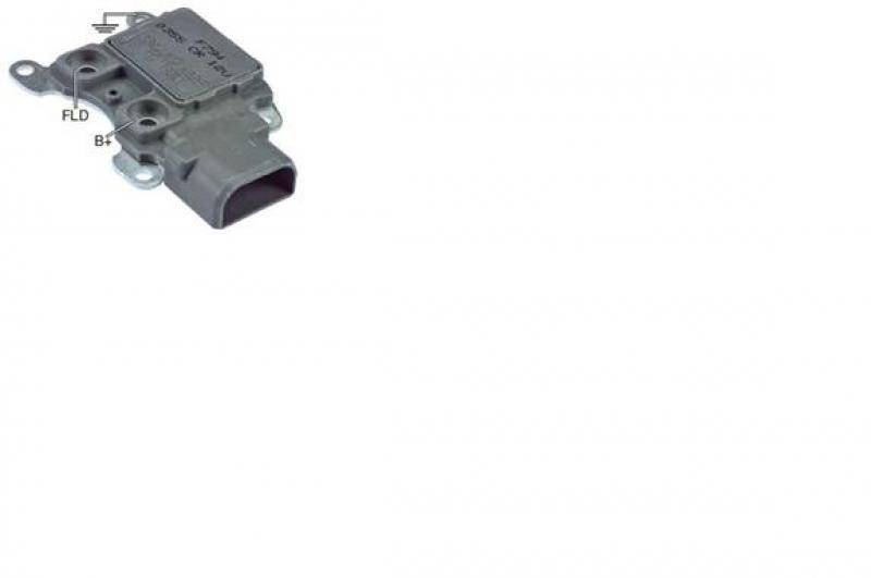

As stated earlier voltage reads 14.2 at 650 r.p.m. with headlights, heater and brake pedal pushed. Those are the high load hogs that tax an alternator to the point that your running on the battery because the alt can't keep up. Imagine what the ignition system sees in voltage. Mine is a dual stage, bolt right in, wire right up easy 3G alternator but there are dozens out there that perform the same. Would you rather mess with a hornets nest of wiring or just three cause this is what the future looks like:regulator.jpg
