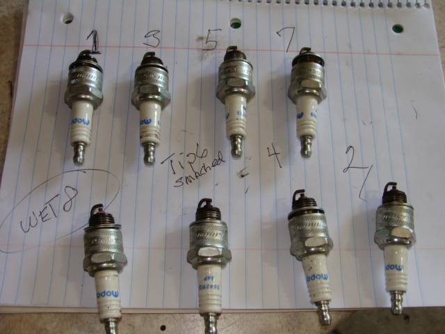

Hi, as the title indicates, I'm chasing down a miss, 1968 Dodge 383/330hp, I had a standard valve job performed and most of the other components are new. The miss has been there before and after the valves were done. SO, I decided to perform compression test. pulled the plugs, #8 had oil on it and #6, the tip was bent. onto the test. thought I would ask for comments as I continue. mike
To me, NONE of those spark plugs looks very good. Other than the two noted plugs, when was the last time that car has been on the highway for an hour or so? On the two flaky plugs, what do the piston crowns look like?
Oil "from the bottom" will wash clean the edge of the piston crown, usually. I'm presuming you looked for "witness marks" from the plug gap being closed?
Just some thoughts,
CBODY67
What's more concerning to me, it wasn't bent when I put it in...
I was gonna say that someone dropped or banged the plug installing it, but this is concerning.
In a stock 383, I can't think of any reason other than something rattling around in the combustion chamber that would do cause a bent strap.

Yeah absolutely. I actually installed the plugs while the engine was out on the stand. Thats the easy way. I will say we should have gotten all new tune up stuff for the car, but I reused the plugs/wires it had when it came to me as I was under the impression those items were recent. I am certain I gapped all the plugs before putting them in, is it possible I missed one? Maybe. I don't think so...but maybe.

Thinking about taking the valve cover off and look for what? The other issue is #8 wet, I could actually see a drop of oil on the tip of the spark plug, where's that coming from, cause a misfire also.
And what did #8 plug smell like?? Oil, gas, or both? Ref post #2 above.
