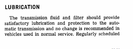

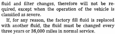

I was reading the manual for my '73 Fury and saw that they recommend (require?) that the transmission's bands be checked/adjusted whenever the fluid is changed. I'm not familiar with old Mopars, but I don't remember seeing such a requirement for other cars (at least older Fords). Is it bad for the transmission to change the fluid without doing bands, i.e. could the new fluid cause slippage or something where the old fluid would have otherwise worked (perhaps due to debris in the fluid)? I don't really like horsing-around with transmissions, so if a drain/refill requires other work I'll probably just take it to a pro, but I was curious.

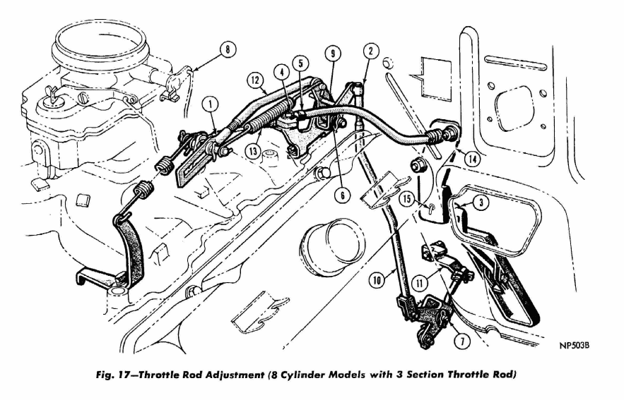

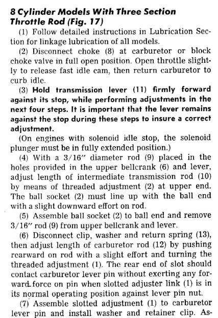

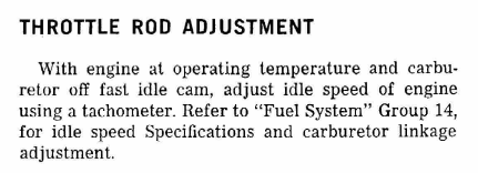

If anything, make sure your "kickdown" adjustment (apologies to Big_John :poke:) is set exactly according to the FSM and go drive the car, enjoy life. Don't go looking for trouble!

I saw those FSM comments way back when our '66 Newport was a used car. I asked the local old-line Chrysler product service manager about adjusting the band as a normal situation.
His reply was "I've run them tight. I've run them loose. No difference". End result, don't do anything UNLESS there is a slippage issue, or some other shift quality concern. So we just changed fluid every so often and all was well. With over 150K on that particular transmission before the car went into storage.
In a situation where there are lots of upshifts and downshifts (think NYC taxi) AND there gets to be softer shifts, or slower shifts, THEN a fluid change and possible adjustment might be warranted. Possibly similar with trailer towing in the mountains? "Normal" use? As long as everything works well, don't worry about it.

I had a 727 fail to engage in reverse on a very cold morning. The problem was a very dirty filter. I replaced the filter, adjusted the bands and filled with new fluid and ran the trans for seven more years with no problem. None of this is difficult and IMHO is worth the effort. As a side note, on a couple of 904's, I have squeezed a couple years out of a tired (slipping) transmission by adjusting the throttle rod to give more pressure. Not a proper repair- just a "band-aid"! Lindsay
