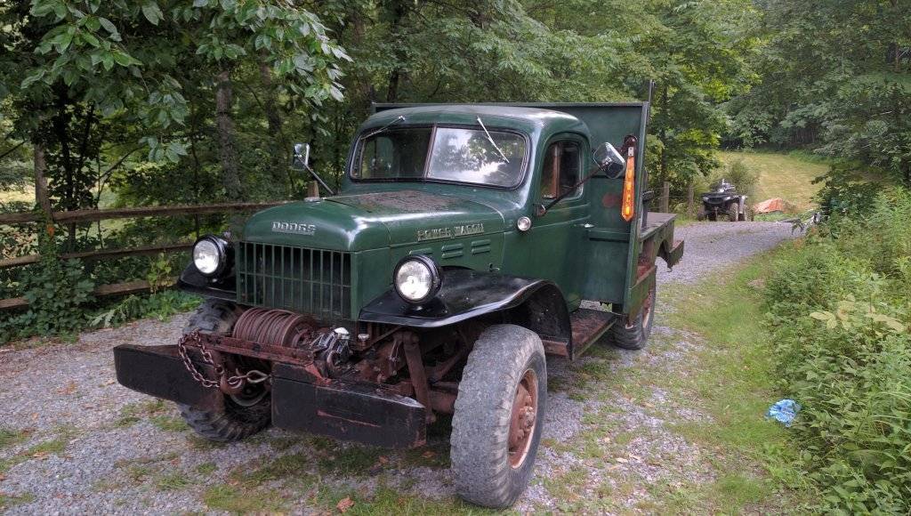

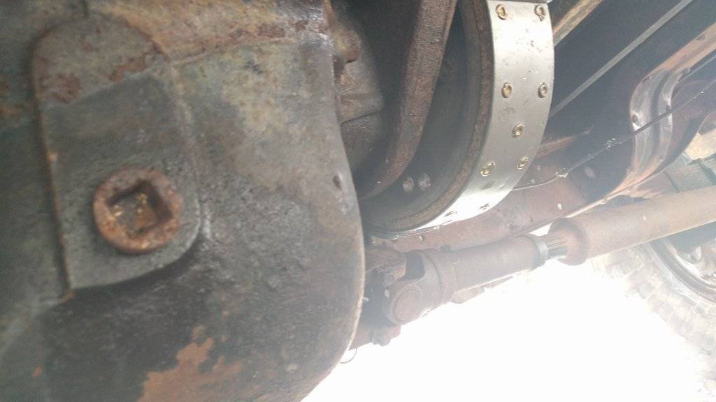

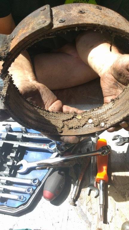

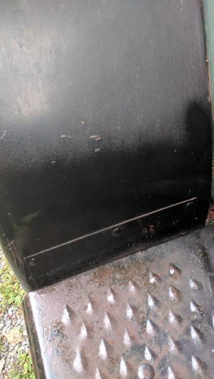

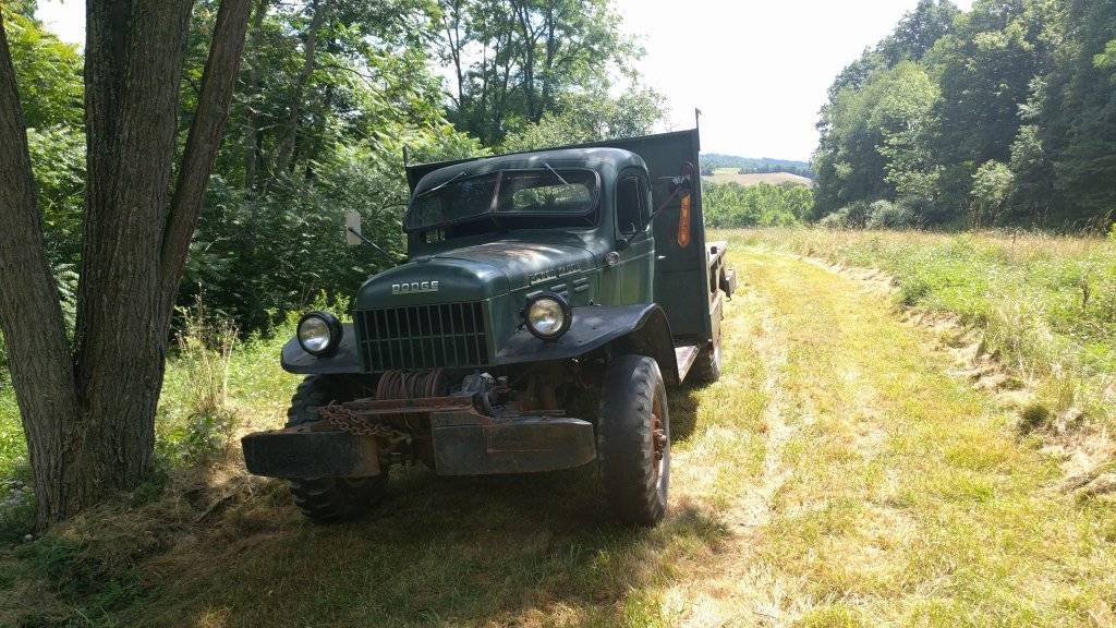

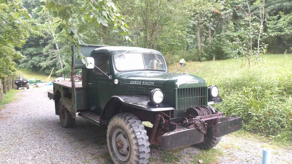

Here is the build thread for my new truck! It is an original truck from California, wearing original paint and gear. It even has the very rare original one piece floor mat. It has a T-137 (230CI) flat six, four speed crash box, Braden MU-2 winch, and a Mico brake lock kit. It also has original bullseye headlamps, an E7T1 carb, and pintle hook. Unfortunately, for this first post, I can't show what we did in detail, as I wasn't there for it. My dad got up very early and decided to fix the hand brake. Oddly enough, it is identical in form to the 1955 Ford F500. Weird, huh?
Old:
New:
Now that the parking break is done, I was able to drive it (in the yard). It drives like a truck with 18,000 miles on it. It's awesome.
Sorry for such a short first post, but more detailed ones will follow soon. Stay tuned!

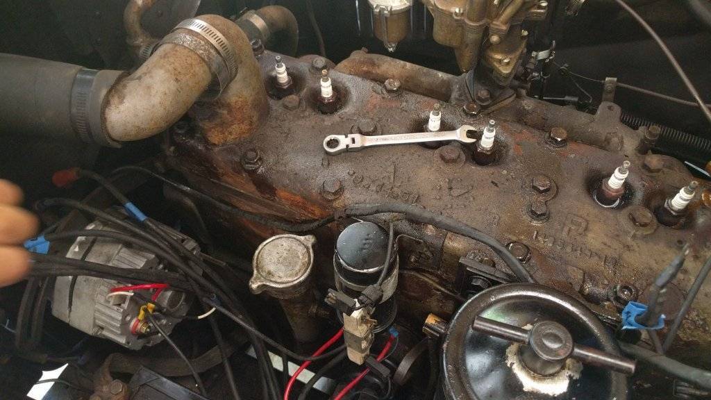

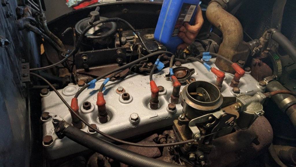

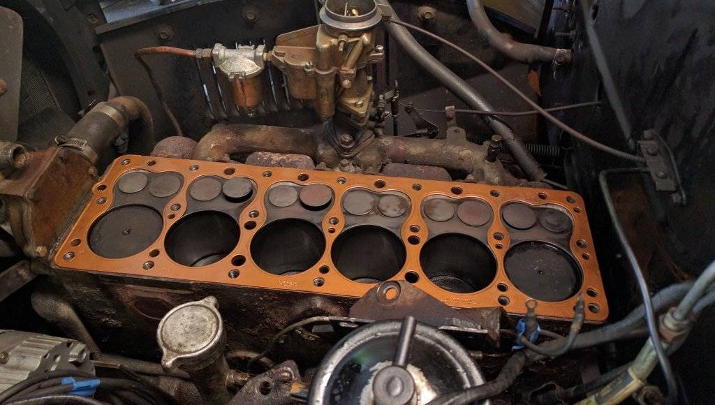

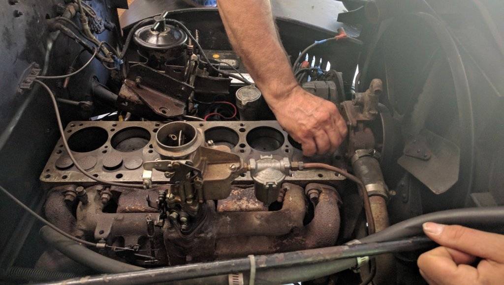

This is not Cherry Blossom, but I figured I'd post this here anyways. My uncle, dad, and a few friends changed the head and head gasket on a '46 PW today, as it blew up during a rally. I couldn't get too many pictures as I was working, but here are the few I snagged.
Before: '59 Plymouth car head:

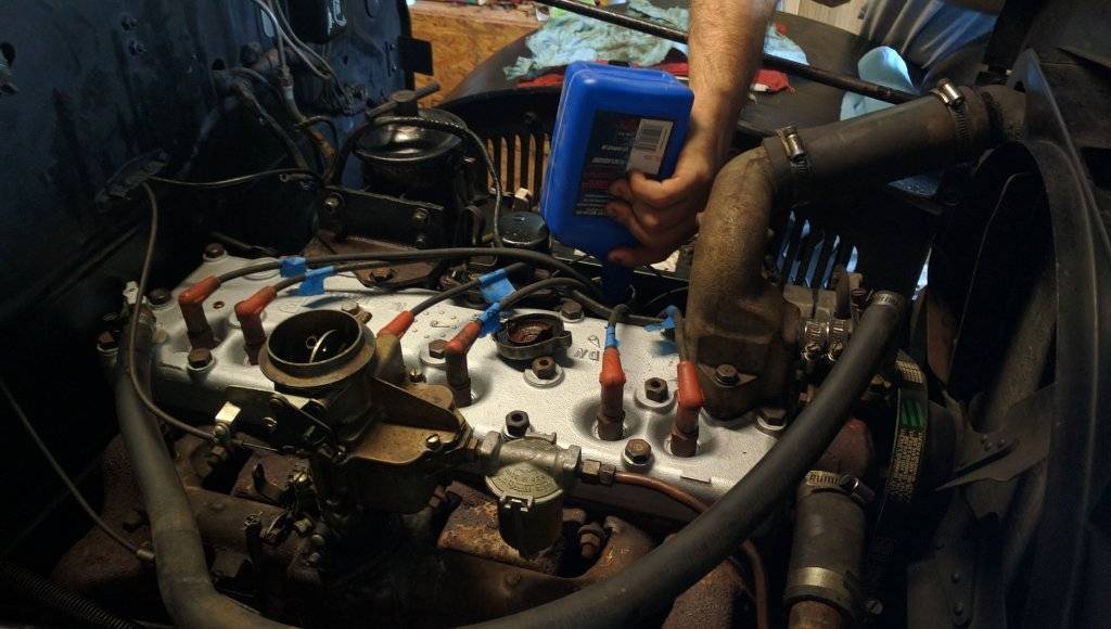

Head off:
Cleaning head bolt threads:
Nice gasket coated with copper sealant:
Nice High Compression head:
We have flushed the oil twice to get most of the coolant out, but will be doing it again tomorrow. I can post pics of the truck and interesting features of the engine then.

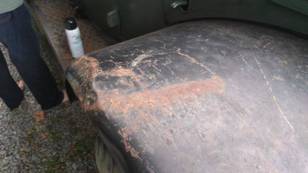

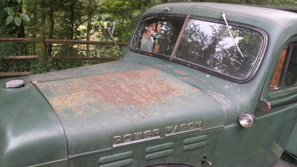

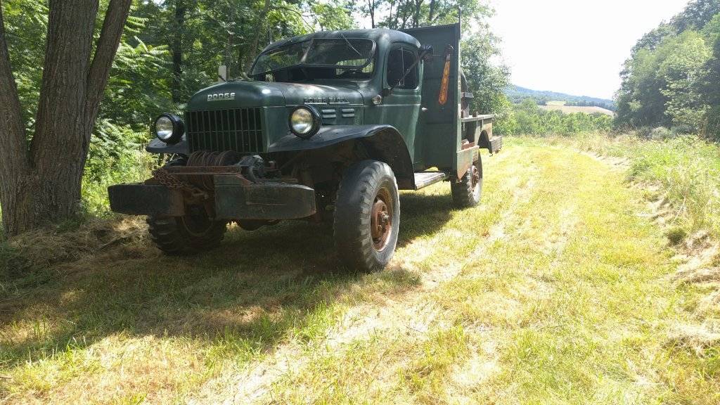

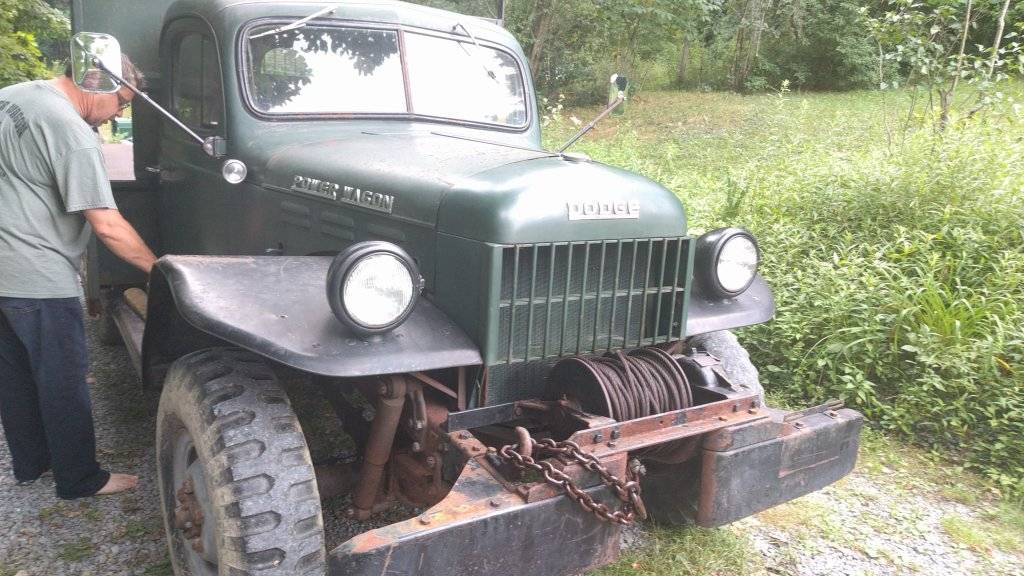

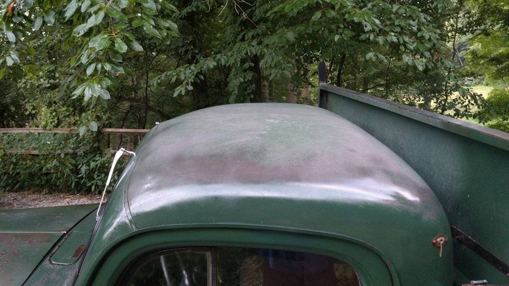

Here is what I did today:

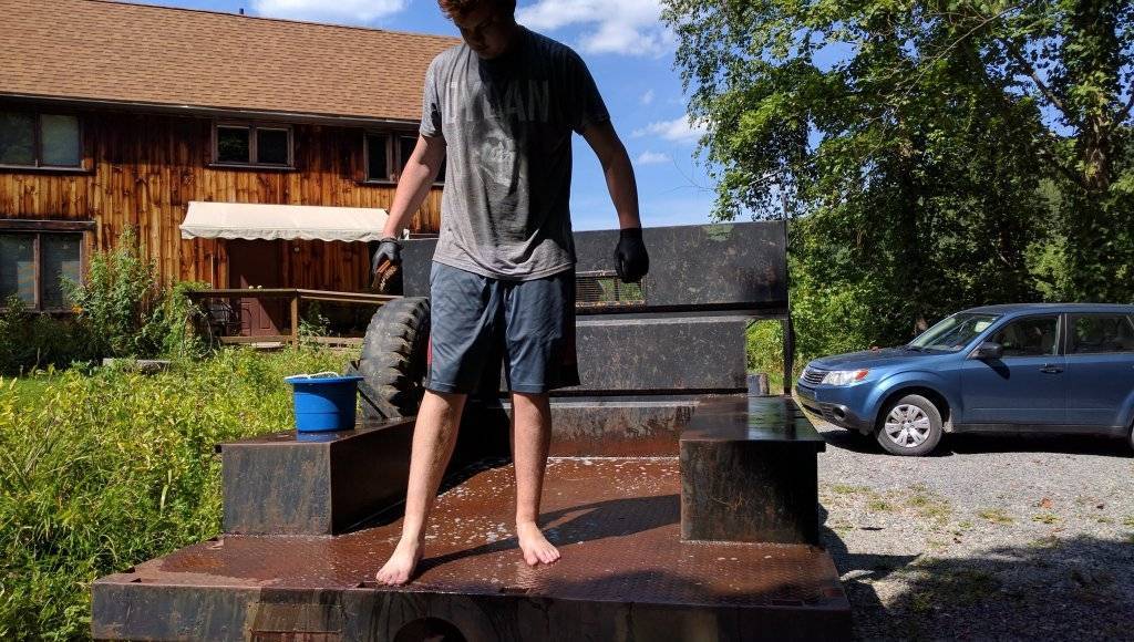

Because I know my mom will hate the rust, I have decided to coat the truck with phosphoric acid. Basically, this converts iron oxide to iron phosphate, a black benigne substance. I was worried this would alter the paint color, but I am very pleased with the results so far.
Washy, washy:
Clean:

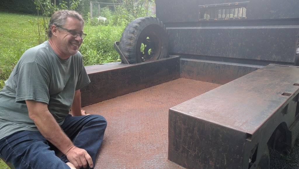

Roof comes tomorrow, along with bed:
The paint has been woken up drastically by the ospho. Hopefully it will last. It will take overnight for the rust to convert. To keep the gleam on the paint, we will actually oil it. The oil protects the paint too.

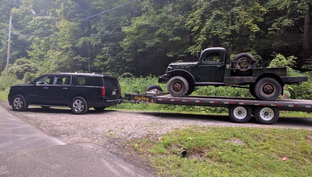

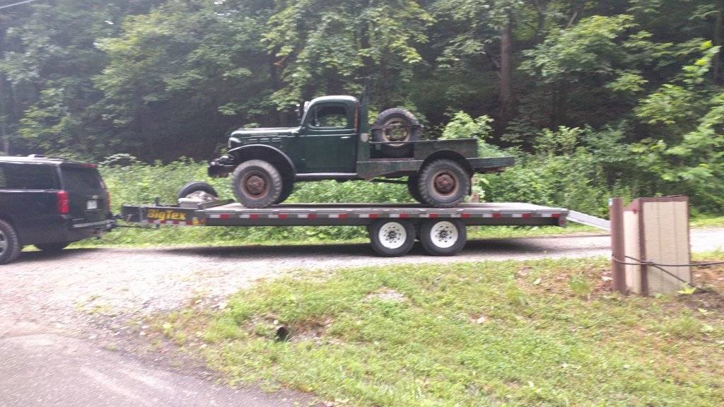

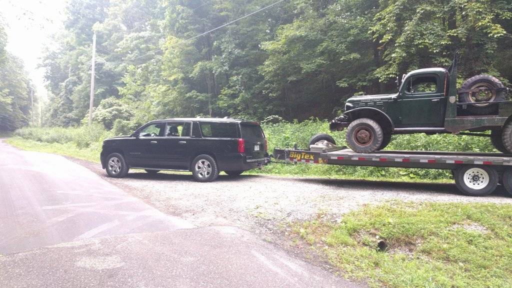

My Uncle and I loaded the beast on the trailer today. The poor Sub(par)urban doesn't know what to do with itself. Wish us luck on the way home.
I missed this thread, love the truck, I'm a big flat fender fan myself. That is a hefty load for that half ton, stay safe, I'd bet you are close to max for that 'Burban.
Look forward to seeing more.
That's a lot of tongue weight on a 10 bolt rear. Order new axels from rock auto now so they are there in Texas when you get home.:poke:
That poor burb is crying...
That Big Tex trailler is huge... I'd be tempted to put Cherry Blossom on back wards right where she sits or at least back her up a couple feet to take a little weight off the tongue... I don't think it would do anything but improve the weight distribution in that picture...
Sweet truck... and a safe journey home.
img_20160728_073809-jpg.87056
What isn't shown in the picture are the load leveling bars. They help a lot. I changed up the positioning a little and it's set up as well as it can be. Im going to split the trip into three or more days and go about 55-60mph. It's gonna be one helluva ride.

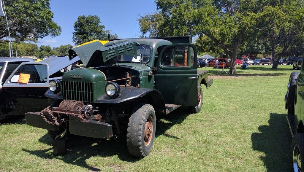

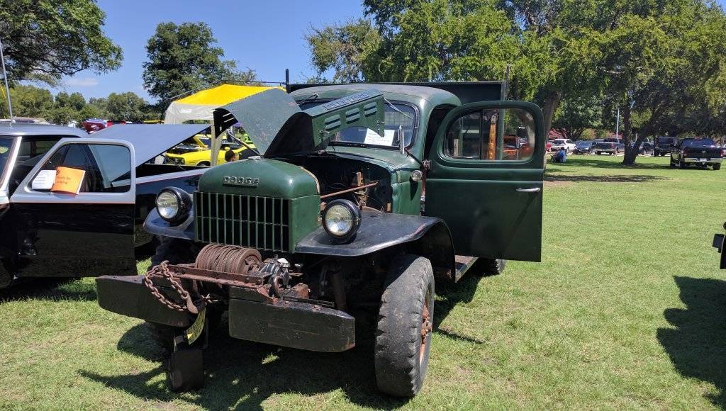

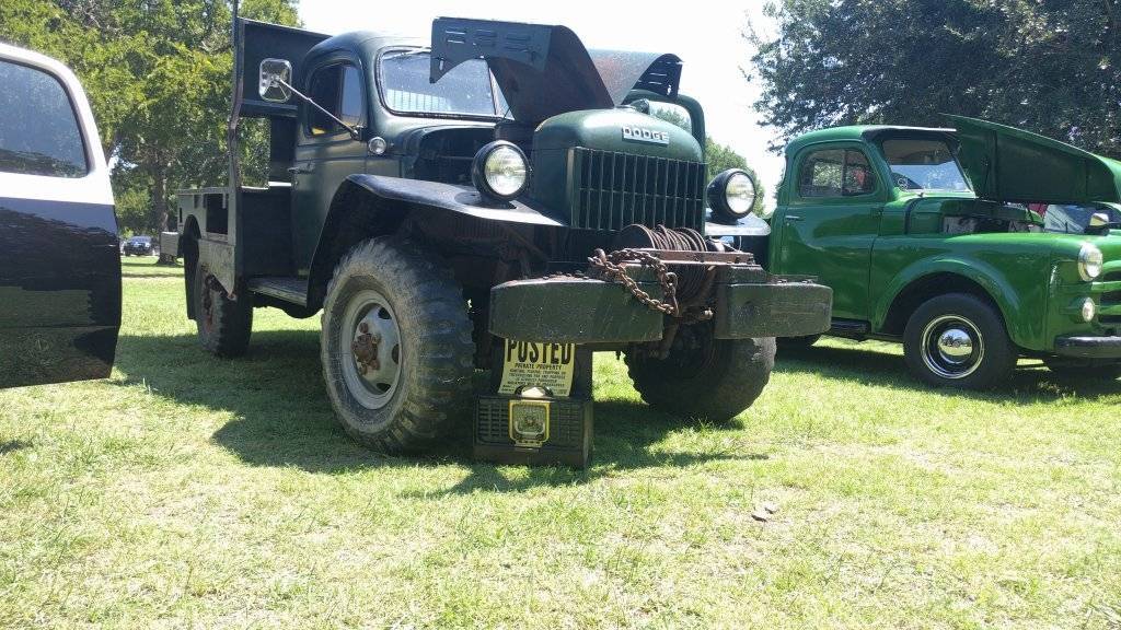

Cherry Blossom is attending it's first car show today. I'll post a follow up if it wins anything. :)
Oh, and some spooty old B Body is here too. :D
