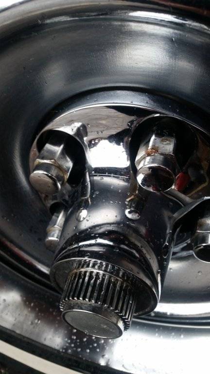

    Just a little word of caution here....8 months ago in April , I purchased a full set of 1/2"×20 chrome acorn wheel nuts from Rockauto in Denman boxes. I fitted them within a couple of weeks of receiving them and they've not been off the car since.
    I clean the car quite regularly and when washing it today I could see that pretty much every one of them is starting to rust. Just another nail in the coffin of Denman and the chinese products that they use. 20191208_144010.jpg

    Helps to wax them first, and install with a 6 point deep socket powered by hand to minimize fracturing the chrome.

    Look up McGard lug nuts. They are US made, triple chrome plated, and offer some that look just like the stock Chrysler nuts. I have had a few sets on different cars, and have been well satisfied. They are the only type I buy when needed. Also, I put a layer of masking tape in the socket first, and carefully tighten or loosen.

    Impact wrenches would crack the OEM lug nuts over time. Almost all of the ones on my '70 Monaco were cracked (with rust underneath) when I got the car in '75.
    There used to be some plastic inserts to us on the deep sockets to prevent such.

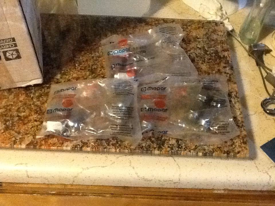

    image.jpeg I found these NOS today. I bought these in 1988 and never used them. 10 RH and 5 LH threads.
    I don't have any projects to use them on. If anybody is interested?

    I could use them?

    McGuard used to offer their chrome lugs with a "Lifetime" warranty, claiming that they were immune to impact damage or they would be replaced. They also made them in the US.
    They are no longer made here and the "lifetime" damage warranty is gone from the package. A shame, because they still charge a fortune for them!
    From the website:
    Warranty/Returns. To the original purchaser McGard LLC warrants its parts, other than chrome plated lug nuts/bolts, against defects of workmanship and materials for a period of one year. ... This is the only warranty on McGard products and no other express warranty will be binding on the manufacturer
    If you have access to a show quality chrome plater, I would take my damaged lugs to him. The Chinesium plating used on today's chrome lugs is thin and I often wonder if they don't chrome over rust!

    Did these sell @SGT FURY

    Yes, they sold.

    Now I just need 5 more LH's and the set will be complete.....
