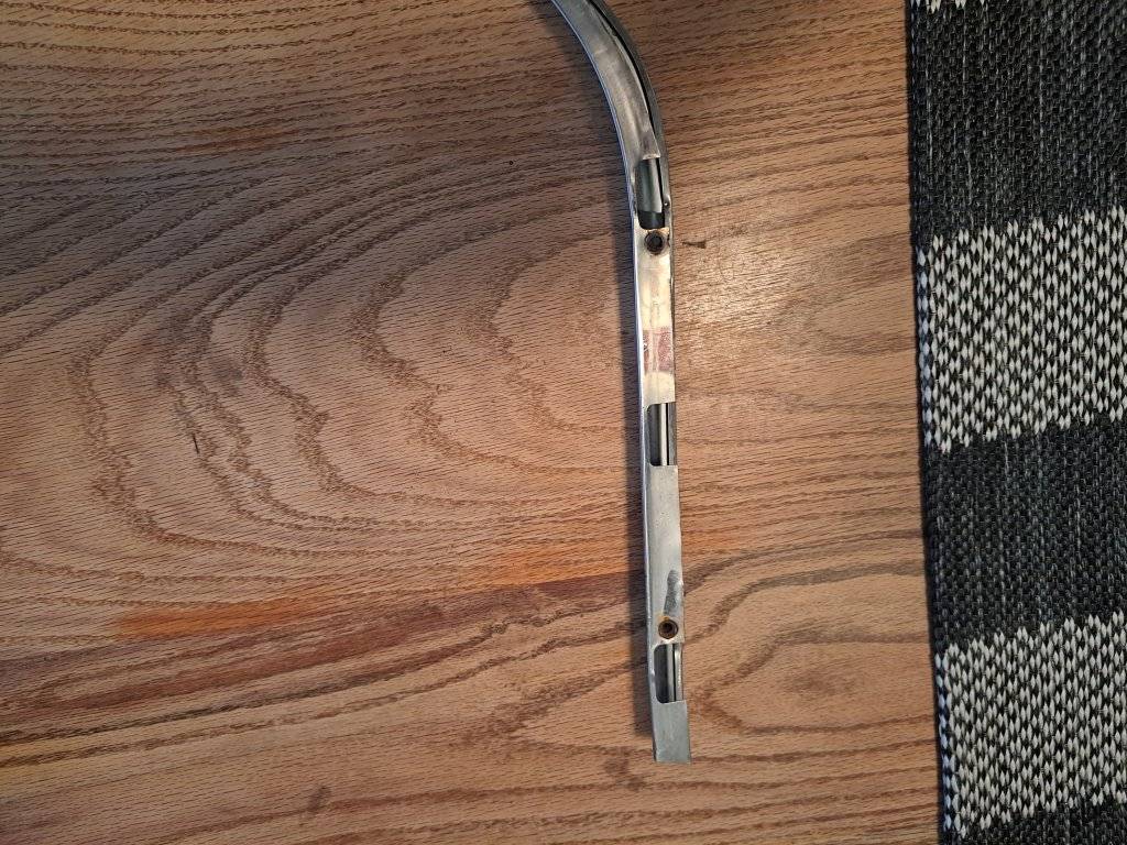

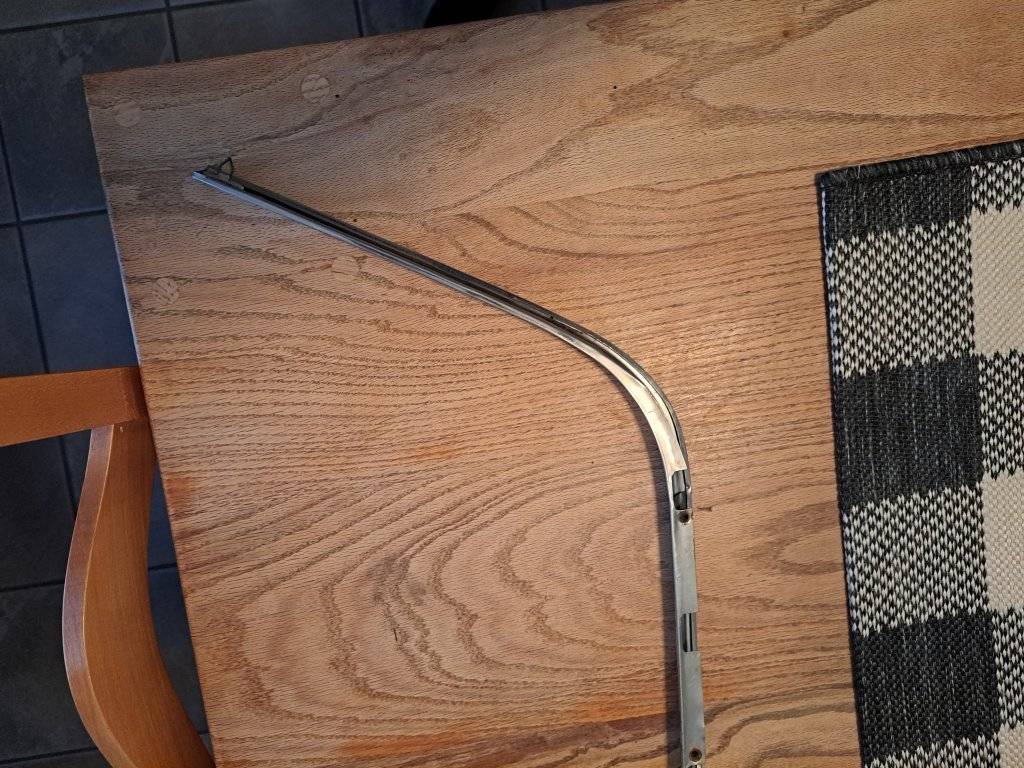

Need some help guys. Got all my chrome trim removed except the pieces that go below the quarter windows on my 68 sport fury. The bottom part seems to just have the standard metal clips.... but as you go towards the curved piece.... it seems that something else might be holding them in place. What am I missing guys. Any help would be greatly appreciated to this ole man. Thanks in advance.
There are clips at the bottom and screws inside the sail panel towards the rear. Be gentle removing the sail panel. Very easily cracked.

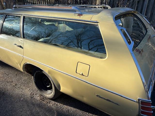

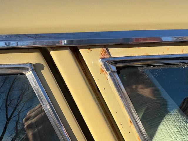

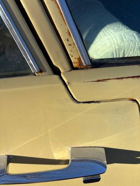

Wow- perfect timing on this thread as I was wondering the same thing about the trim around my rear windows on my 72 Fury wagon. I was thinking of cleaning up a bit of the rust but not sure how to take the trim off.
