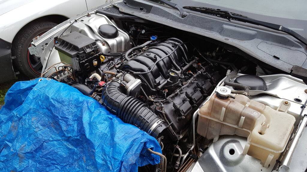

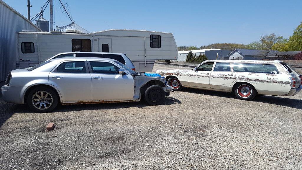

    Last week I picked up a 2006 model that was in an accident with a deer. It's been sitting 2 years. Was told it ran and drove normally with no issues before the accident. 168k on the odometer. With a fresh battery I can hear the fuel pump prime in the ON position, but turning the key to START does absolutely nothing. No starter noise or clicking. I can spin the engine manually with a breaker bar.
    I guess I'm starting this thread because I'd love to hear opinions on this drivetrain. Not even sure what I plan on doing with it yet. More than likely stuff it in a fuselage wagon or coupe. I'm not very educated about this subject, so any threads/pics/articles/links shared here would be greatly appreciated. 20210426_121352.jpg

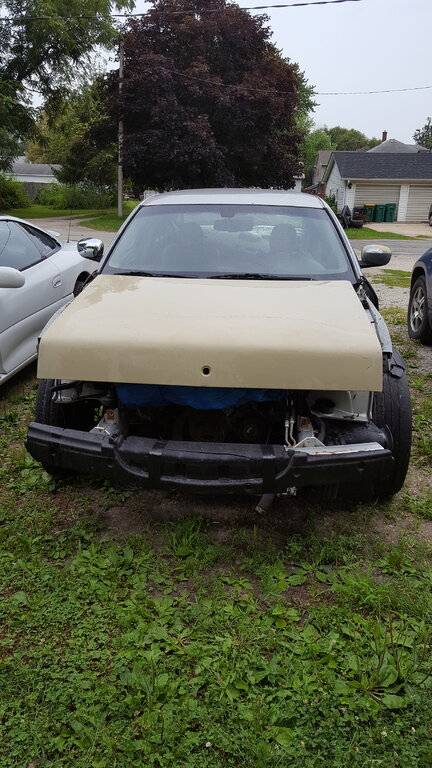

    On a side note, a fuselage Imperial trunk lid makes a nice hood LoL 20210710_114110.jpg 20210710_114046.jpg

    I hear that modern cars will shut off the ignition or the injectors if the computer senses that it was in an accident. You might need to give the computer a reset, if it gives you the option. A scan tool might give you the option.

    Pull the codes. See what's not happy.

    Think of the FUN you could have with a carb'd and distributor'd Gen III Hemi in that fuselage wagon, as cruise attendees didn't know what kind of engine it was! It would probably take up about as much space in that fuselage engine bay as a LA motor might, I suspect.

    Get a scan tool and check codes. Is there a theft light on? That will be a great drivetrain donor to a project car, with the whole car you can swap as little or as much as you want. I would use the engine, trans, computer, harness, try to fit radiator and fans, but I work on modern car every day. The way Cbody67 suggested is a easier method. I look forward to seeing what you do with it.
