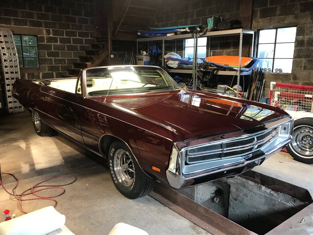

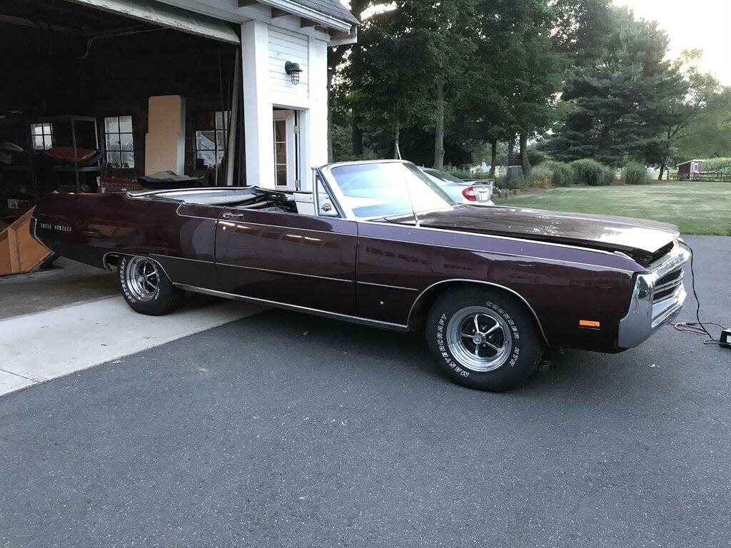

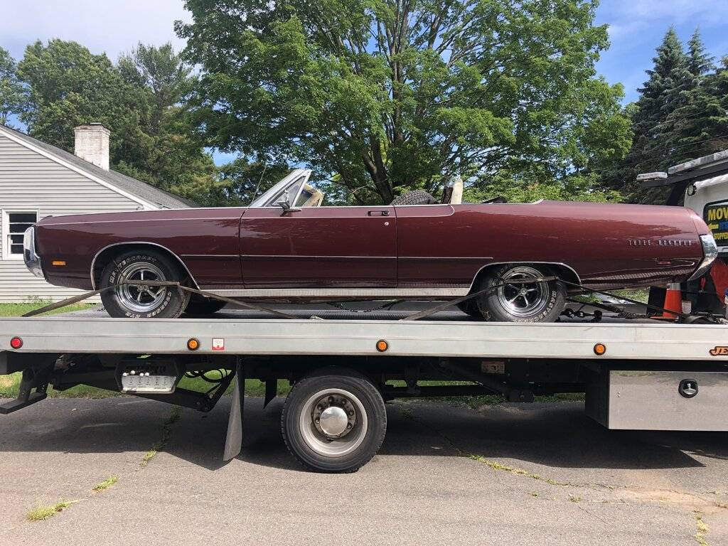

Hello All. I have recently acquired a 1969 300 convertible. Before agreeing to purchase it the previous owner agreed to let me have it towed to my garage at my home (which DOES have a mechanics pit built into the floor... never thought id get any use out of that because I'm just not that mechanically inclined) and have my local mechanic come take a look at it. He said the car was in great condition except for one thing... the motor was seized! He gave me a tip which I'm sure all of you know which was to remove the plugs and fill each cylinder with either MMO or what I chose to use, Justice Brothers 80. After only 1 day I jumped down into the pit and after removing the fan and shroud I put minimal pressure o n the camshaft nut and voila! it became "un-seized". Good sign right? So n ow we are having it towed to the mechanics shop where he will flush the fluids, etc, etc and try to get it running. Id love any input that might help a rookie like me understand what I am getting myself into, what to look for, etc. I ve looked at many forums but believe this to be my best shot at gaining knowledge that will help my enjoy my new ride for years to come. BTW - 1933 total produced I guess? Any idea how many are still in existence/up and running? Thanks in advance to all.

That is a very nice looking vert. If the motor was stuck, the car probably sat for a long time. You will probably need to go thru the brake cylinders, calipers, master cylinder and hoses as that stuff goes to hell pretty fast on a car that is inactive. Do an underside inspection of the steel brake lines replace them if they are rusted. You should also figure on replacing the belts and hoses and doing a full tune up. Do an oil change on the engine, service the transmission and rear end. Hove the mechanic pull the valve covers and lube up the valve stms so that they do no stick. Most likely the carb will need a rebuild kit as well. The battery is also most likely shot. Once you have the car running you can evaluate the brake booster as those are often bad on a car with extensive down time. Check the code dates on the tires, if they are more than ten years old those should be replaced also so you do not have a tire failure that causes you to crash your new ride. That should get you to the point of being able to drive the car and that should make it reliable. This car came from the factory with R-12 in the A/C system if the car has air. That refrigerant is no longer produced. Most conversions use R-134a and the RV-2 compressor fails often using that refrigerant. You might want to consider converting to a Sanden style compressor if you want functioning A/C. There are several posts on this site about making that conversion.
