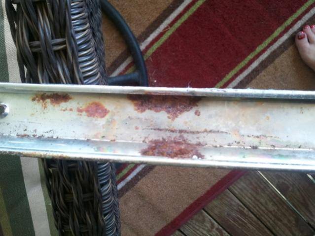

Vacation is over. Back to second job. Restoring interior trim. I've watched the videos. (Thanks 300rag). I'm very good at accepting advise. I'm wondering, do I buy a bench grinder/polisher. Hand held grinder/polisher. If so , what type? I know most of you are experienced in restoration and I regret that I am not. The only way to gain experience is by being guided. That's what I am looking for. I have tried 600 grit but it does not take out rust "pox". I'll be trying to use more "true grit" today. (Yup, John Wayne initiative...what can I say..I'm a Texan") Will try to attach pic of what I am working with. 2012-07-14 10.26.28.jpg2012-07-14 10.26.46.jpg

For me that's purty bad though I'm sure others have seen far worse. If it were mine, I'd be wet sanding (with sandpaper) at about 500 grit and moving up the ladder to about 1500-2000 grit. Then polish. The trim is thin and shouldn't/wouldn't take much at all so go slow and light. Although I don't know if you'll ever get all of it out.

I would take it down smooth with steel wool. Then polish it clean with autosol. I have been real happy with there products. They have won 3 gold awards and are the only polish used in the Smithsonian museum. I would start with oo steel wool, move up to 01 then 02. and wash real clean with mild soap and water then let the polish clean off the rest. Here's the link to autosol. I have bought from this seller twice, and the are in austin Texas. I live close to San Antonio,Tx Jason
