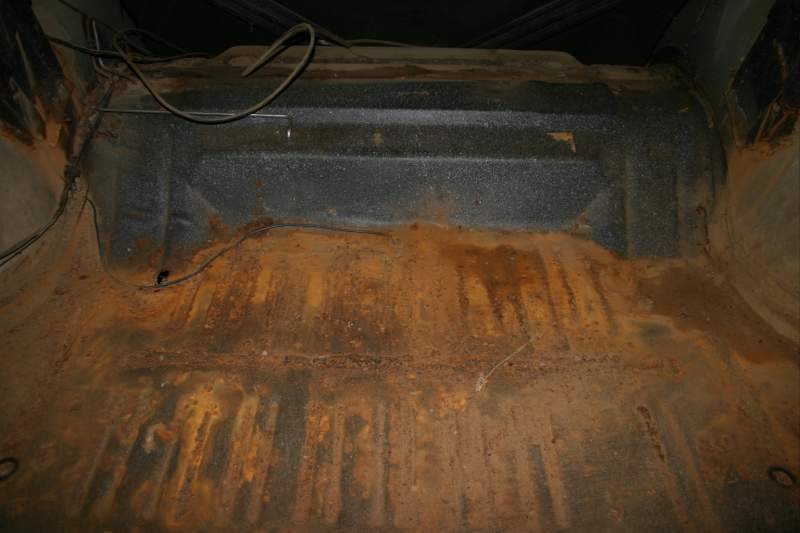

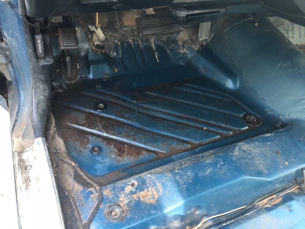

    I have some rust on the floor and trunk pan of my project car, but nothing that seems to need more than light resurfacing and I'm trying to figure out the best way to clean it up.
    I've seen threads where people just hit it with a wire brush, some marine clean, and POR15 it, but that seems like it might be in cases where the rust is much worse.
    Should I try to use a rust dissolver as referenced in this thread Rust Dissolving liquids? or plan on attacking it by grinding with something like one of these 3M discs Rust never sleeps....
    When I do get all the rust off it, what are some options to paint/coat it? I do not have a paint gun.
    Here's a picture of the worst of the floopans and the trunk.

    Yeow. That's pretty nasty back there.
    Attack it aggressively with a wire wheel on an angle grinder to see what you end up with first. Then make a decision on Step 2.

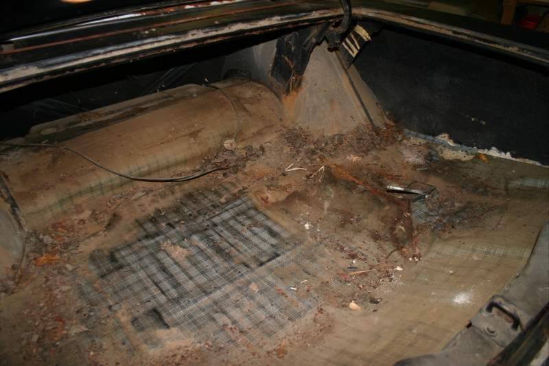

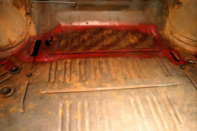

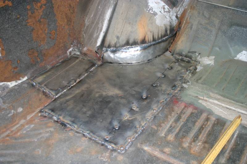

    You never know till you go at it with all sorts of tools. Follow up with a pick hammer (lite taps), you will know if it is bad.
    Before
    Cleaned
    After

    Fair assumption that you had to cut out and replace the red section?

    Correct, I replaced that piece, last repair I did before handing it off. My body guy started here.
    As you can see the rest of the floor was solid and it looked as bad as yours.

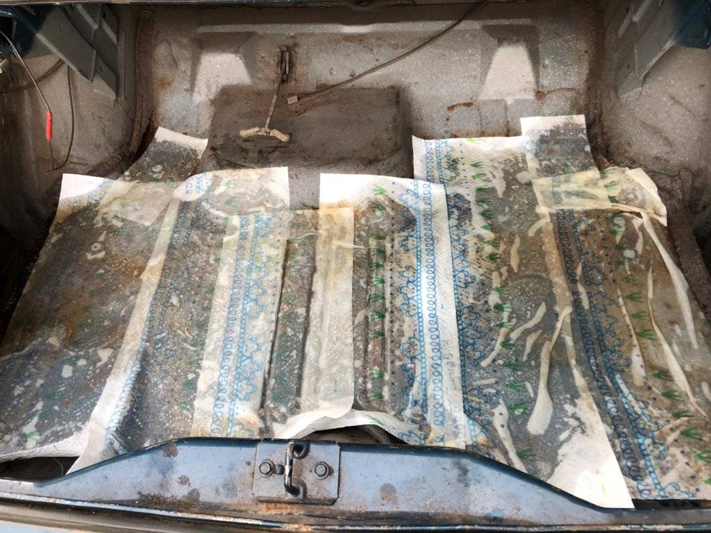

    Started on the trunk today.
    First just hit it with a stiff bristle brush and a shop vac to get the chunks out.
    Then got after it with a 4.5in angle gringer with a polycarbonate abrasive pad from Harbor Freight. Bad lighting makes those black spots look like holes, but they aren't. There are few holes by the rearmost plugs and a few more in the upper right quadrant, all are less than a quarter inch I'd say.
    I soaked some paper towels in Evapo Rust and covered them in plastic and will let that sit for a bit to see where it ends up.

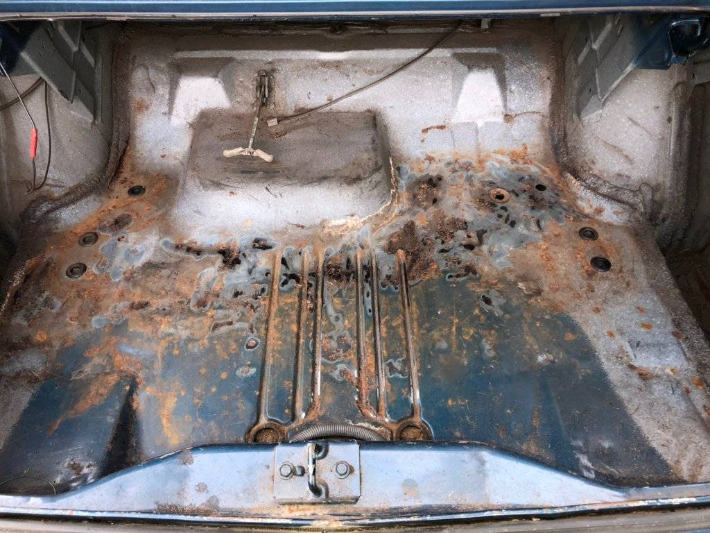

    First pass with the Evaporust, ~12hrs of soak time.

    Went at it with the angle grinder using a polycarbonate abrasive bad, a twisted wire cup, and a twisted wire wheel. Front floor pans are better than I thought, trunk is worse.
    I'm giving them all another bath with Evaporust / Metal Rescue, but after that I'm not sure what I should do to protect them. Based on what I've read hitting them with Eastwood Fast Etch, then a pre paint solvent, then primer might be the way to go for now. Thoughts?

    I use the Fast Etch on a lot of small parts when I am detailing to keep from flash rusting. Plus it should kill any remaining rust and leave a phosphate coating. If left on too long before rinsing with Pre it will eat the rest of your paint as well.
    I am not a primer expert, but if you will be cutting and welding patches in a welding primer should work.
