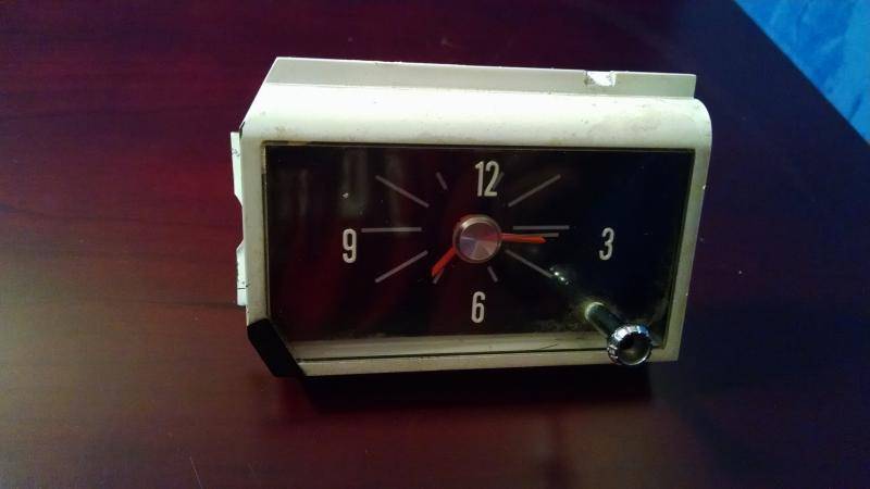

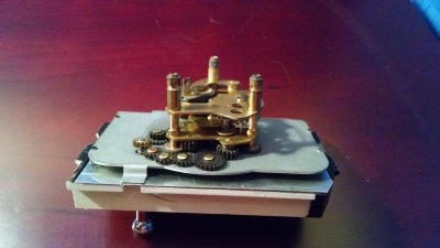

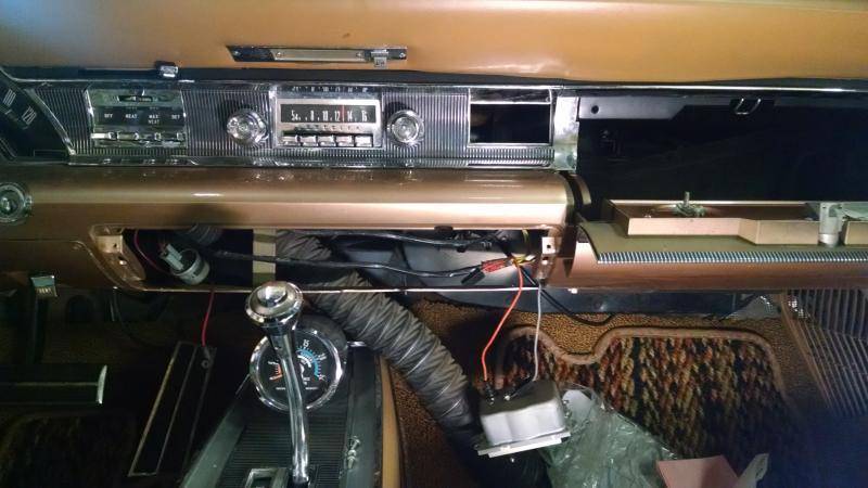

Using his post as inspiration, I removed the clock from the dash this weekend and made an initial diagnosis. The mechanical clock itself does not will work, so I have no idea about the electric portion yet. There is nothing broken so it must be the gunk keeping it from working.

I think it's rare to have a working original and if two or three people pipe up and say there's is working I would still call it rare. I had mine converted to a Quartz movement and is on the list of things I will never have to revisit.
I am a bit of a clock nut. Mechanical clocks and watches are my favorite. The Borg clock fascinates me and would love to get it working. I'm hoping I am successful and I realize even if I am it may be temporary. I like mcmlvii approach, of not using a quick shot with a electronic cleaner.
In the event of being unsuccessful, where did you buy your quartz conversion Matt? I always try to have a plan B.
That's really cool. The clock.... A fun winter project. Some folks overlook that stuff. The details and components of the mechanism are impressive. Thanks for sharing that post.
Did they actually repair or convert it to a quartz? if they repaired it how long has it been running since the repair?
They repaired it. I like the tick-tick of the second hand, so I didn't do a quartz conversion.
I just got it back a couple weeks ago and it hasn't been powered up yet, so I have nothing to tell you about that. Turn around was just under two weeks with shipping.
I have an extra clock that I wanted to see if I could get it working. I disassembled and washed down the entire gear works with WD-40. Let the excess drip off and connected to a 12 volt dc power supply. It started to tick away. I let it run for about a month or so on the bench. It's been about a year or so since I disconnected it. I can try it when I get home from work and give an update if it still runs. You may want to clean the points up.
The problem with WD-40 is it contains a gummy lubricant that remains after the solvent carrier evaporates. I've have read many places that it's a paraffin base lubricant.
That gummy paraffin causes all kinds of problems.
We've repaired hundreds of dial indicators/calipers/micrometers and quite often the cure for whatever was sticking was to clean the WD-40 (or Starrett M1) residue that some misguided soul had applied and oil it sparingly with the proper oil.
If you don't believe me, ask a good gunsmith about WD-40. They will tell you to never use it.
They do make some cleaners just for clock movements.
