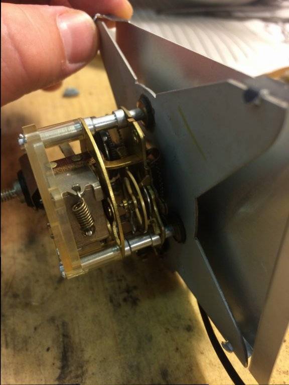

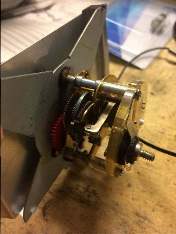

Hi all -
I've finally been able to spend some time taking apart the dash and all the components in it. I was able to repair the clock and get it running again. I've had it hooked up to a battery for over a week now and it seems to run about 10 mins fast every day. I haven't found much in the way of manuals or how-to's on these. Does anyone know if/where there's an adjustment on these babies?
The clock in my '67 is auto adjusting. Keep setting it backwards and it should automatically correct itself. If yours isn't then I don't know.
Thanks guys, I'll keep setting the time back and let you know how it goes.
Happy Thanksgiving to you and yours.
FYI it took mine all summer to start keeping pretty accurate time. I was having my doubts but it eventually came around.
I fixed mine a week ago and tends to try to fool me.
it keeps time during the day but gains overnight by 10
+ minutes :p
I guess I need to be patient as well:rolleyes:
