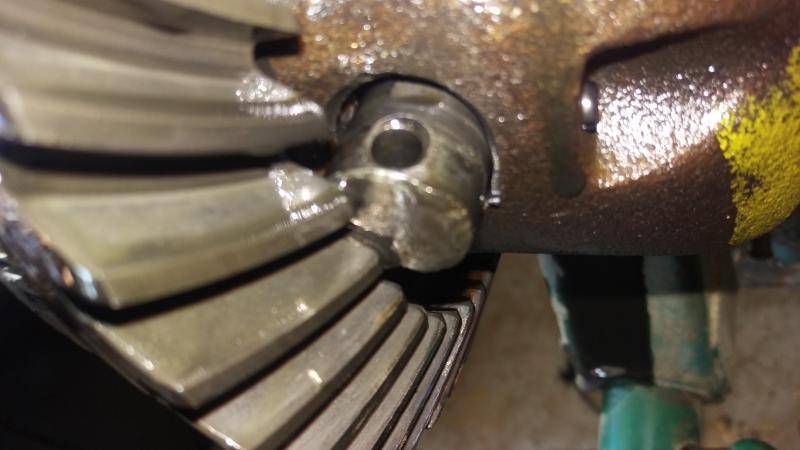

So the other day I hop in the Polara to go for a drive. Well I put the car in reverse and hear a ping from the rear end. So out of curiosity I back down the driveway and put the car in drive to hear a clunk clunk clunk noise. That's not good.
So I'm off work today and decided I better look into it and this is what I found.

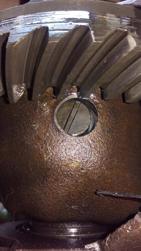

Your roll pin sheared off and your carrier is wiped out where the pin rocks, so what have you got to lose and this will buy you time to find a new center ect.. Get the pin pushed back up into its hole better(off the ring gear) figure out which way the pin moves under forward motion usually the direction of the most smashed. Once you get the pin kind of located where it should be weld it in place. Put a bead all the way around each circle to hold the pin in place. The ring gear can still be taken off if you choose to put a different carrier in this center but you will never get the side or spider gears back not that you will want then anyway.

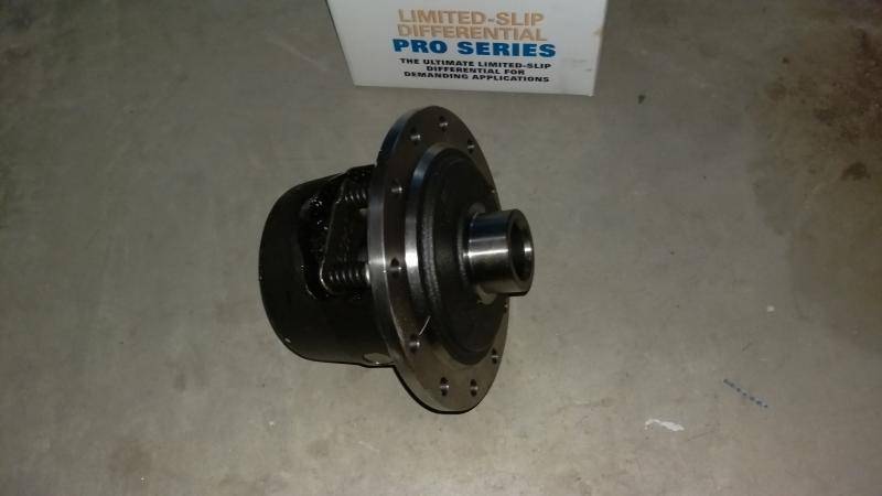

So since I go past Summit Racing in Sparks alot in my work travels I have decided that I'm going to stop by this week and pick up a Auburn pro series for it. Any body have any experience with using one of theses units? I have a friend with one in a blown 65 chevelle and he likes it.
