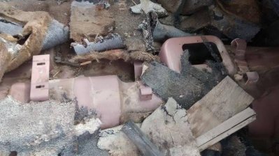

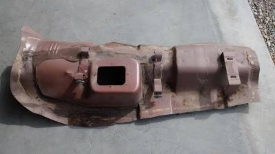

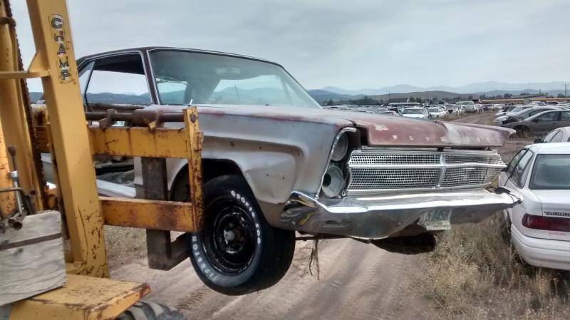

This morning I hit the local wrecking yard (2 miles away) and got the trans hump that I need for my '68 Chrysler 300 4 speed conversion. Bonus is that the floor section also has console mounts that I can use. Even better was that the yard guy did all the labor to cut it out for me! I think the donor car was a '65 Fury that still has the 383 4 BBL in it. The trans, bellhousing, flywheel, and pedals are long gone, but the steering column is still there. Sadly it's damaged from being pried on to remove the steering wheel.
Trans Hump and Console Mounts (3).jpgTrans Hump and Console Mounts (1).jpgTrans Hump and Console Mounts (2).jpg
