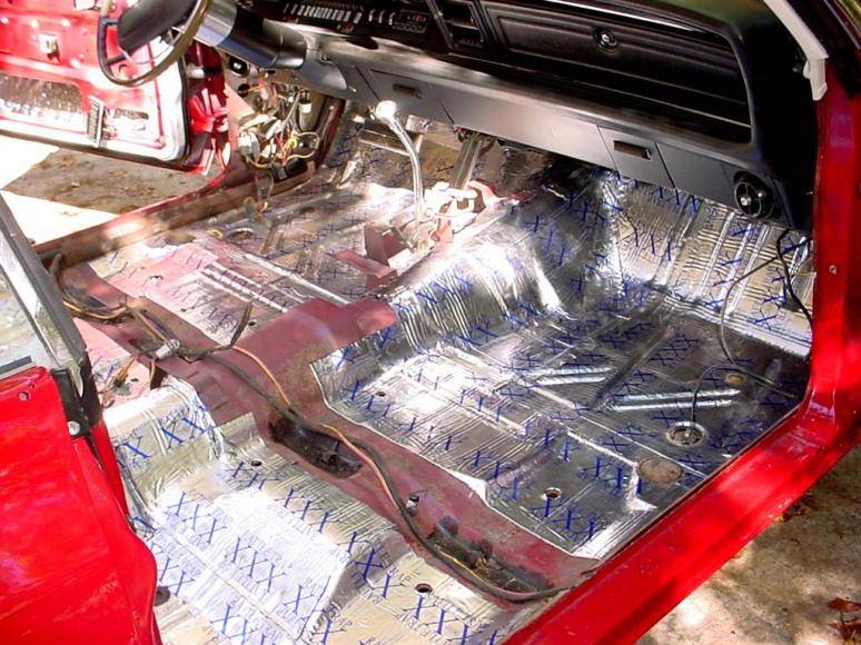

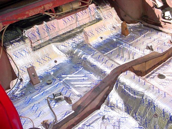

My two cents...... none of the above.
Once any rust issues are delt with the remaining surface rust areas, (if any), should be wire brushed to remove all the loose rust and then treated with a rust converter.
Next step... a zink primer and body color paint. A great option after that is to line the entire floor with a good quality sound deadner, I used a product called rattle trap... 80 mil deadner with a foil lining installed with a heat gun and a roller.
It's avaliable on ebay.... free shipping. I used 50 sq ft.

Ive always heard not to use rubberized stuff on the floors. Yes it keeps water out, but if water gets underneath it, it will be trapped under it. Then doing the exact opposite of what you want it to do...
This is why I won't use any of those rust encapsulation coatings...nothing is a perfect seal! No rubberized coatings, or POR-15 for me thanks. I would just clean everything really well...maybe some epoxy primer, then some good Tremclad, or Rustoleum paint, brushed on. I have done this many times with great success. And the nice thing is, is that if you have any trouble down the road the area can be repaired, and then recoated very easily.
And this is also how I feel about those peal and stick sound deadeners....what if water gets under them? No way to tell until your floor starts to get soft. Again I'll stick with products that can be removed for inspection, repairs..or drying out if necessary.
