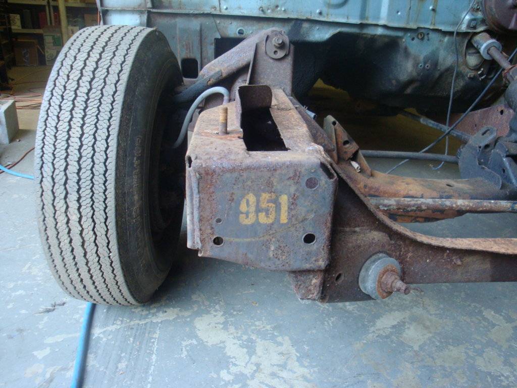

    They had a 3 digit code (which was probably the last 3 digits of the part number) painted on the right front frame horn. I'll see if I can find a photo later this evening if someone else doesn't beat me to it.

    This is on a 1968 New Yorker:

    As Bigmoparjeff posted, there is often the last 3 digits of the PN on or near the bumper bracket area. For Fuselage area cars, (to my knowledge) all V8 stub-frame assemblies are the same, EXCEPT for a car with an front sway bar, and possibly some fleet applications.
    And yes, there is a date code similar but not the same as A,B, and E bodies. Y-bodies have them too.
