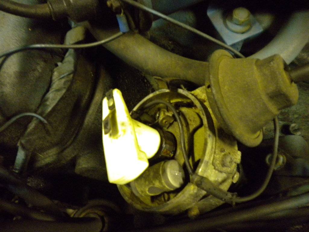

    my crappy '65. DSCN0573.JPG runs perfect. DSCN0574.JPG running or not, yours is still beautiful.

    It does not look that bad to me. You also have a quality low tech ignition that is easily repaired miles from home. I carry a spare set of points and condenser plus a screw driver, pliers and a feeler gauge in a plastic bag in the glove box of my C-Bodies.
