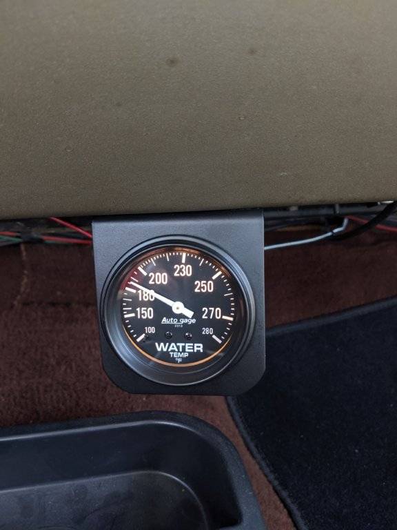

After install, I test drove, 88 degrees today, in traffic...temp never busted 190.
For the money, the above adjustments were no big deal. I would recommend Cold Case
Pics show slot and installed, and temp.

Not certain, but it acted like 180. As the car warmed up to 190, it would drop back down to 180-185.
