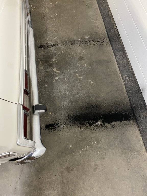

Every cold start on my LA 318 2 bbl I get this residue out of tailpipes, anyone know what’s going on and remedy? Thanks

Warm/hot exhaust hits cold steel exhaust pipe. Condensate occurs and usually collects in the muffler. Which is the reason for the small pin hole on the bottom of Chrysler mufflers, so the condensate can drip out. Condensate washes the inside of the pipes, which leaves the "trails" you illustrate. Completely normal, but a bit messy sometimes.
The other thing is that you should be DRIVING the car as it warms up, not letting it idle and warm up. In that orientation, the gasses get the pipes hotter quicker, possibly, so no "tracks" as illustrated. The side with the less track is the side with the heat riser. Heat riser closes and sends most of the exhaust to the opposite side, via the heat crossover in the cyl heads and intake manifold.

Too rich, either choke or jetting, or burning oil.

I agree with too rich, especially left side (driver side) of carburetor. Look at the difference between the black 2 carbon marks on the driveway.
If the exhaust heat valve is working correctly, most of the exhaust will be exiting the left side on cold start up.

I still think he should check idle mixture with procedure in my last post.
Also, I still think the car is running rich. We'll have to see if he reports what he finds.
