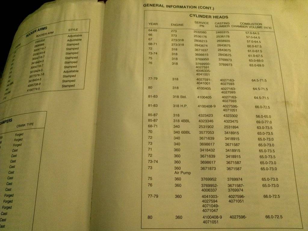

Combustion chamber CC's Chart ??
If there is such a thing it wouldn't be accurate. You have to cc the cylinder head to know for sure. Production chamber cc's were all over the map.
Do you have a specific casting # in mind?
I wouldn't get too hung up on that letter at the end. This chart will get you in the ballpark. Its not wrong from my experience. I've personally cc'd and documented 1971 915 heads with .010 milled off @ 71cc, 1990 302 heads milled .010 @ 59.6-61.4, and magnum heads shave .010 @ 64cc
I wouldn't get too hung up on that letter at the end. This chart will get you in the ballpark. Its not wrong from my experience. I've personally cc'd and documented 1971 915 heads with .010 milled off @ 71cc, 1990 302 heads milled .010 @ 59.6-61.4, and magnum heads shave .010 @ 64ccView attachment 137678
G'Day Dana, Thanks the info which is a pretty good guide, so helpful and thanks muchly, R
