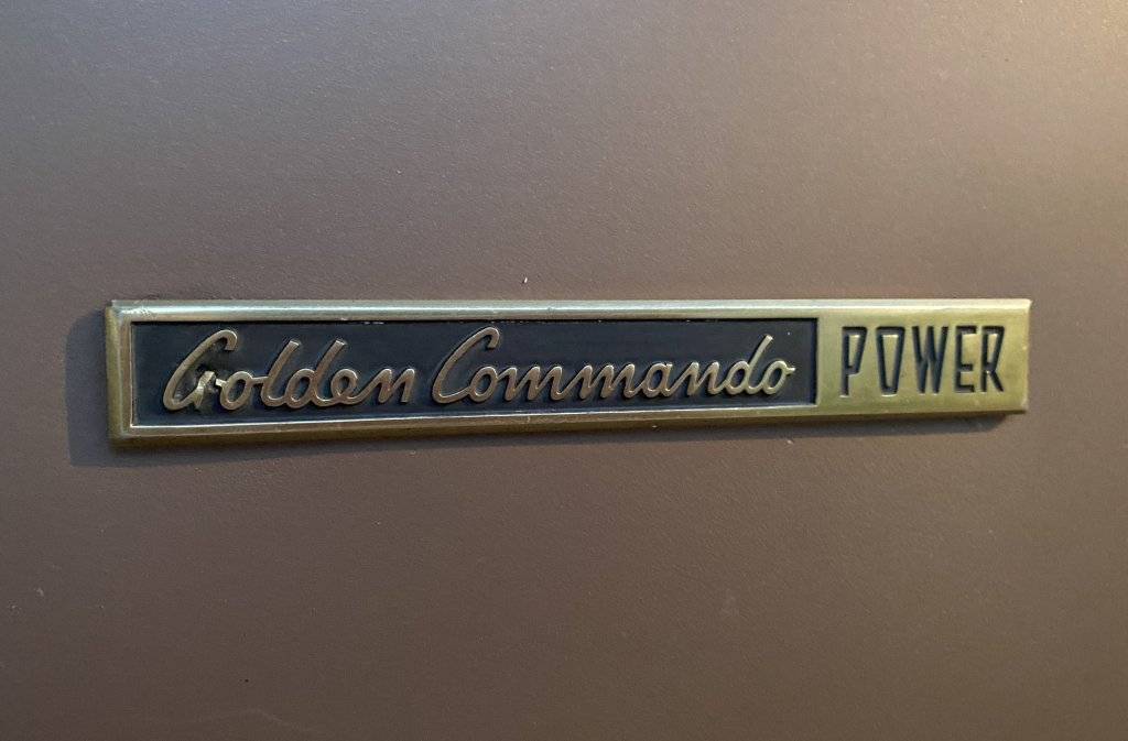

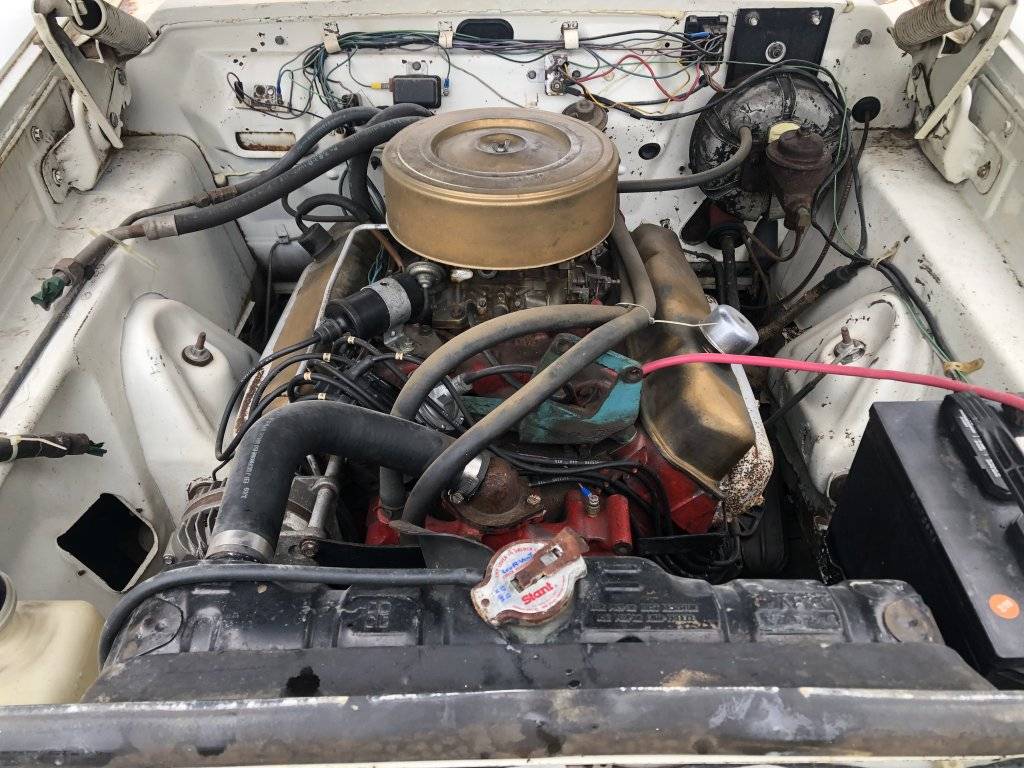

Have a 63 Sportfury 383 factory 4 speed
Does have, gold rocker covers and un-silenced air cleaner similar to slant.
Please note Golden Commando Power emblems are missing! If anyone has ?

I never saw an original pie pan of a '65 383 4bbl. Do you have such a thing on your car? And when..I happy to see a photo of :)
Pie pans didn't come out until 67 and then only on certain models.
My 65 383 has the unsilenced aircleaner similar to what is shown in post #15, this cover was also used on some Slant 6 and 273 4-barrel engines. When decorated from factory, was done with decals. Covers were either gold, black or chrome depending on application.
