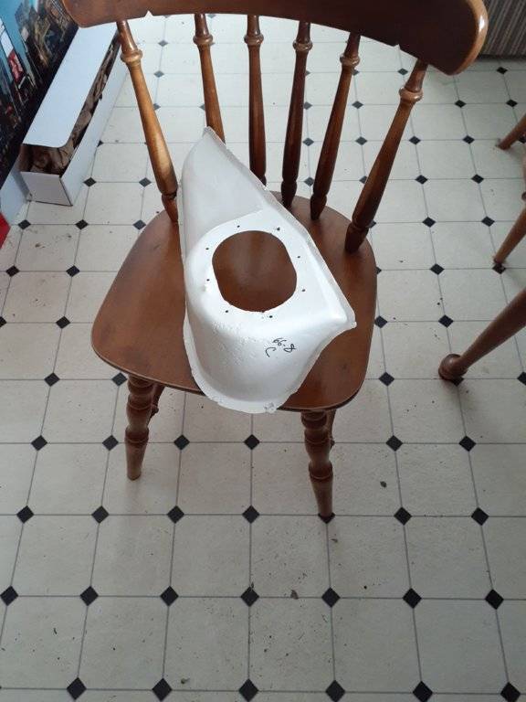

The hump on the side of the console, Stan.
I know.

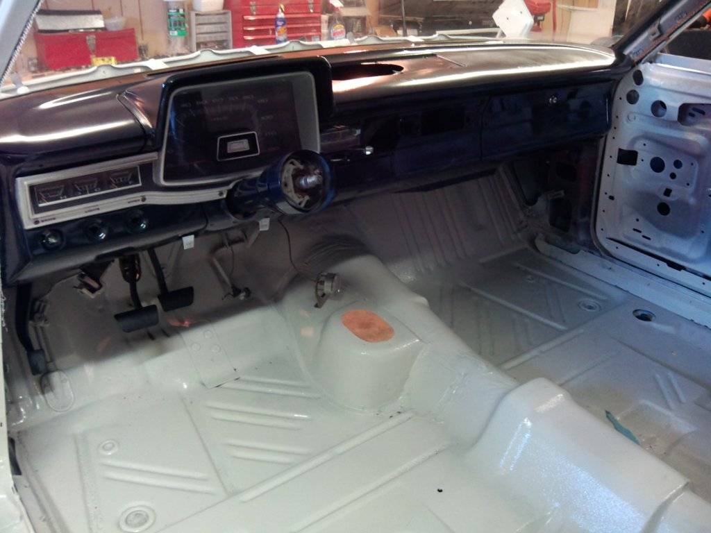

This thing. A C-body 4 spd transmission tunnel hump.

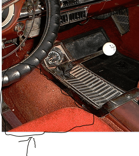

Here's a 65 C Console with the 4 speed side hump.
These are what convert an auto console to a 4 speed one.

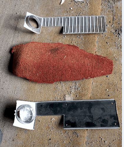

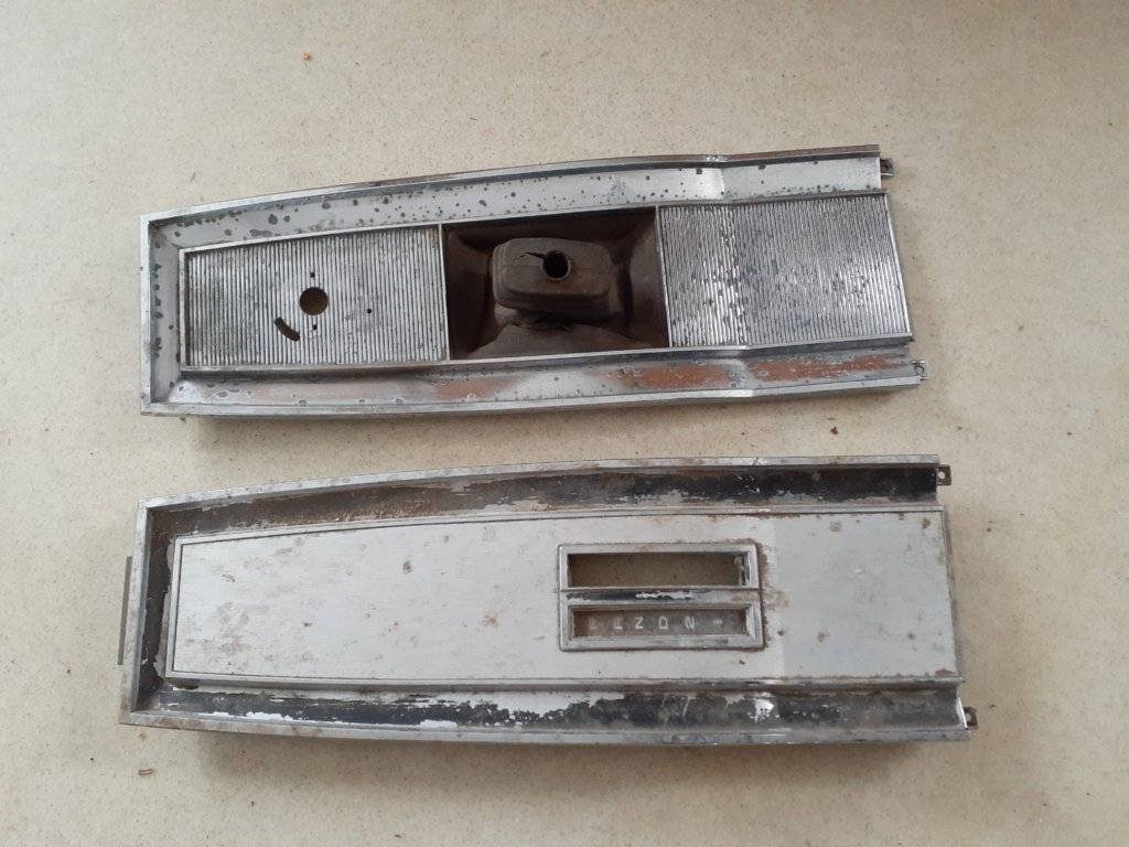

My 66 console is a little different than a 65. A 65 plastic console hump will easily graft on to 66 console after a little trimming to the console. I have a 4 speed top plate.

I'm reading it as he will use the current floor in the c body to determine how to modify the b body four speed hump to work/fit.

He was looking for the fiberglass extension for the console, not the sheet metal tunnel hump. As an Oh, By the way he's going to screw around trying to mod a b tunnel hump by using a proper example.
