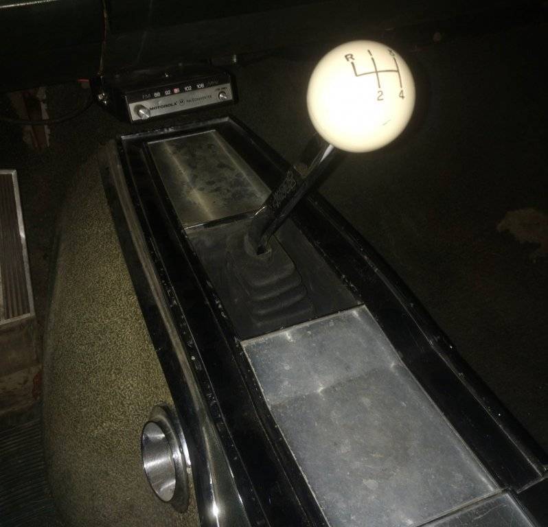

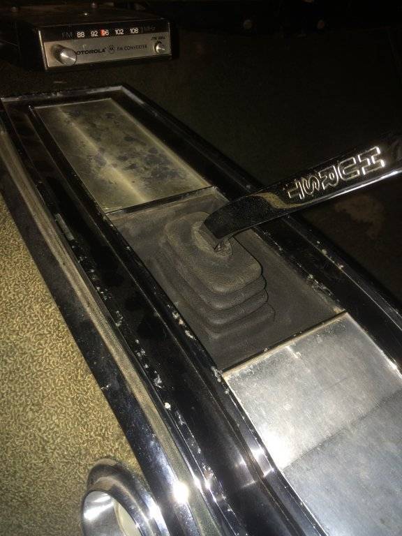

As far as I know the Inland was used in 68 and then changed to the Hurst unit in 69, (possibly late 68). Once this happened, many owners converted to the Hurst as it's a superior unit to the Inland. This what was done to mine sometime back in the day according to the past owner history. It works fine but I'd prefer it had a another bend as it seems to be a little forward of the optimum position.
As far as I know the Inland was used in 68 and then changed to the Hurst unit in 69, (possibly late 68). Once this happened, many owners converted to the Hurst as it's a superior unit to the Inland. This what was done to mine sometime back in the day according to the past owner history. It works fine but I'd prefer it had a another bend as it seems to be a little forward of the optimum position.View attachment 123871 View attachment 123872

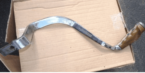

That appears to be a flat metal shifter ... not original. This is what a late 68/9 B/C console shifter handle looks like. Round handle and raked back pretty good.
I felt it was the perfect angle when I used one in a B body.
I know the original owner switched it out, it still had remnants of the original, (round hole), upper and lower boots when I got it.

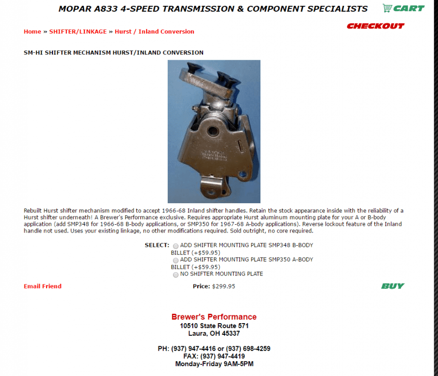

I picked up a cheap non-console inland shifter for the "maybe one day" 4 spd conversion on the wagon. I plan on making an adapter to run a hurst shifter mechanism, but mount the inland shifter to it so it appears original.
I believe brewer transmissions makes a hurst linkage that accepts the original inland shifter.
