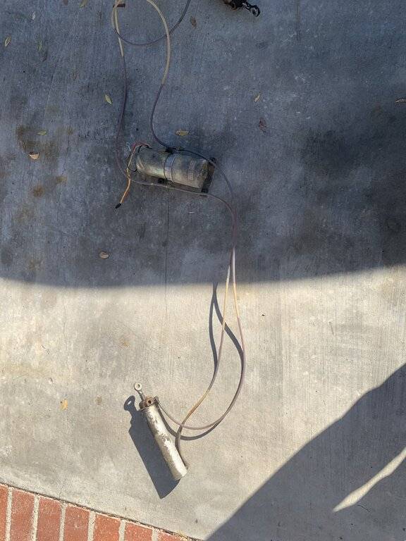

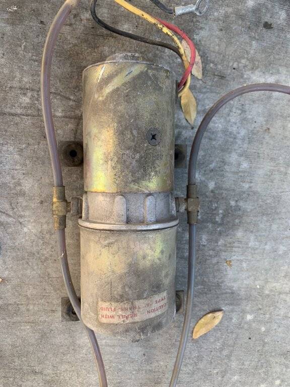

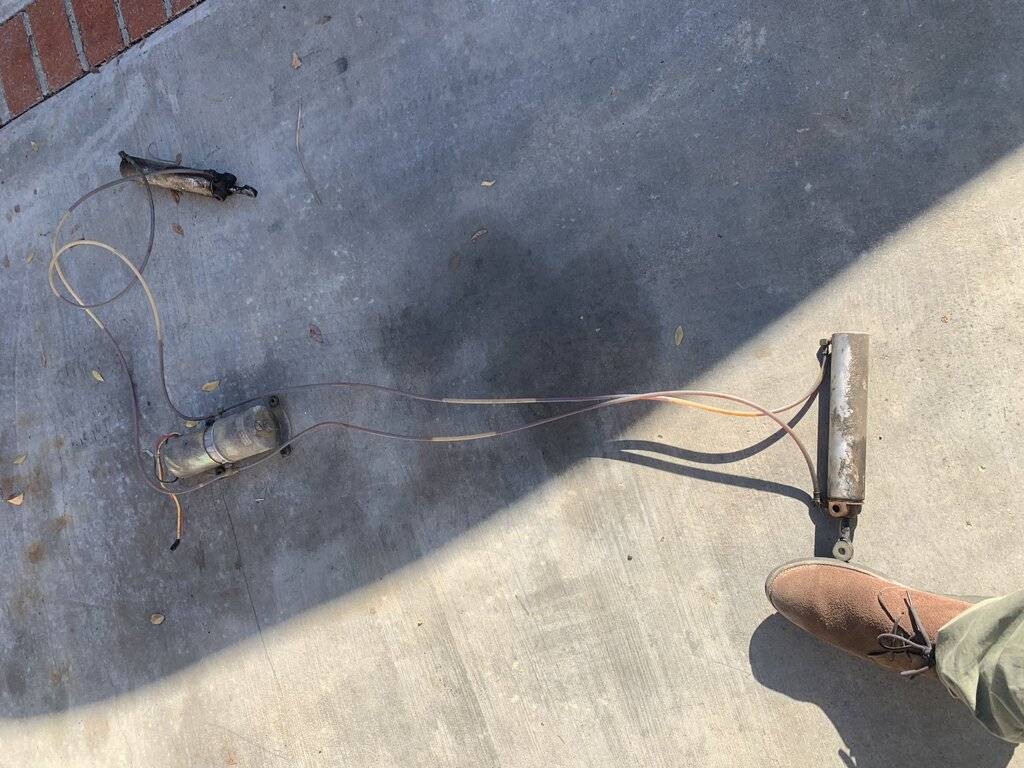

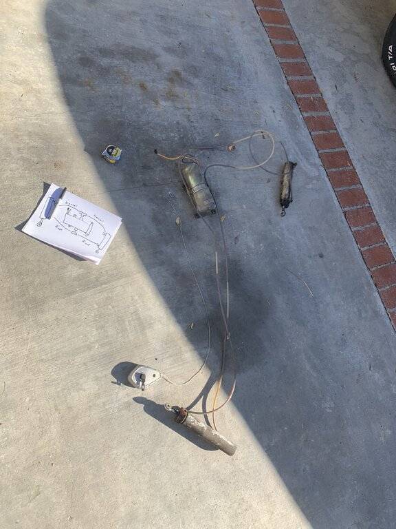

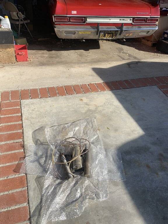

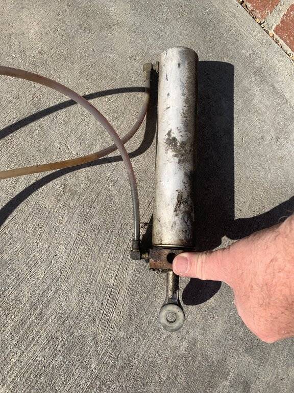

Here’s the set up I bought to put in my 69 Fury.

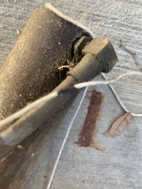

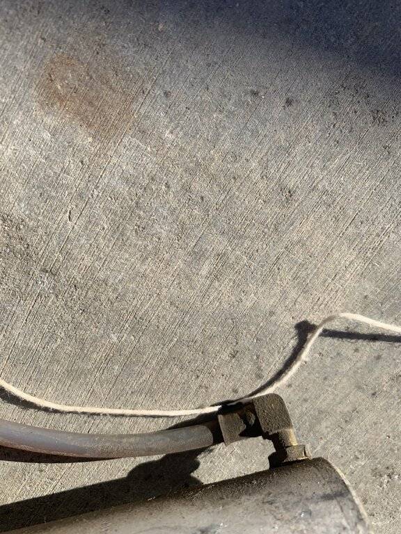

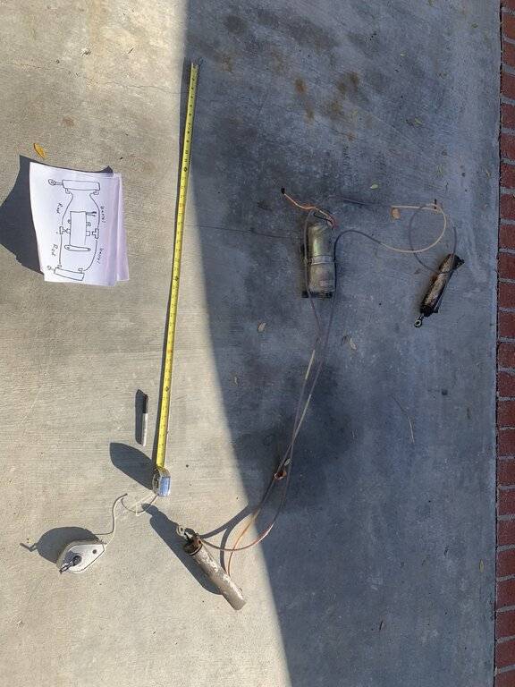

I drew a pic to make it easy. I used my pumb line to measure the length. I got approx 40.5” for all four. Maybe + or - 2/10 tops. I tried not to stretch the string so I think I’m pretty close. I’ll include pics so you can check my work LoL!!!
Thanks ed
Unit mounted in my car
My drawing is going by where the wires are on mine.

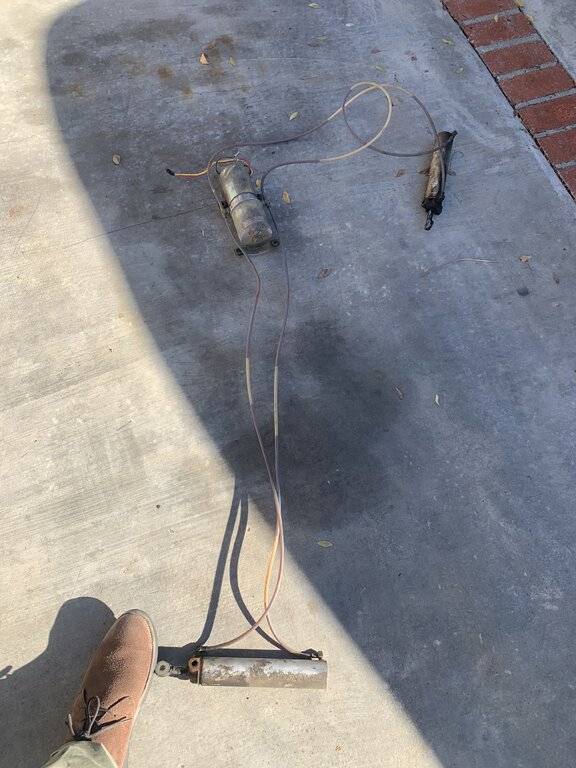

Here’s pics of the mark on my line coming pretty close every time and those old hoses are kinda curly.
You can see they’re all close to same length differences might just be my string. I bet they just looped the extra and jammed it in there. 40.5 inches is about it maybe add a pinch but I can’t see where it would matter.

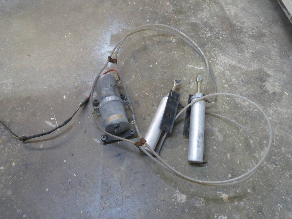

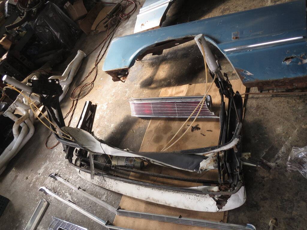

These are pictures from a setup that Matt sold in May, at first I thought it was yours till I saw the fittings, the upper hose has a straight fittings, when installed makes more since. This was said to be a 67 Imperial (hoses would have been the same as a 69 C-Body.
Alan

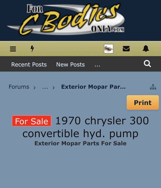

Found it
I guess it’s a 1970. Might be different than 1969 but it’ll work fine for what I’m doing. Let me know if you find a source for the pins and cotter pins. That’s all I need to install my stuff. Thanks ed

In 70 they used the same hose for top and bottom, it was the same as the lower hose in earlier years.
This will work for you.
