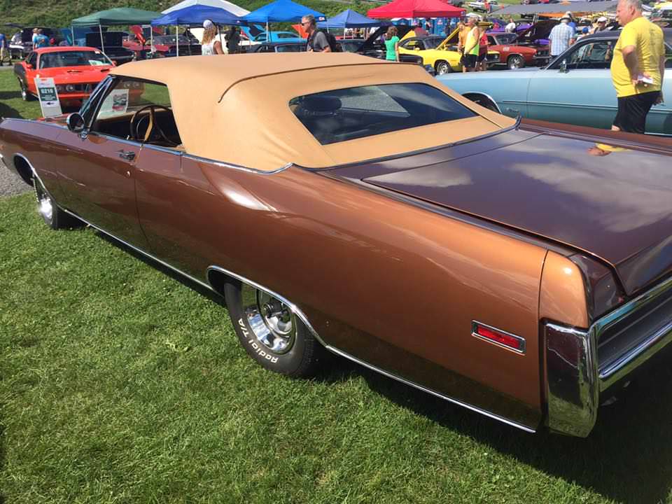

I like the idea of that horse hair brush, I need to get one too. Looks like it would be the ticket for a vinyl top too - fine bristles to get into the grain. Auto Geek is a great site.
How about the plastic rear windows? Any recommendations?
The Polara's is pretty nasty.
I've never done one myself, but I was thinking to use some like Meguirs Plast-X after a good washing.
This guy is pretty through, although the first part of the video concerns cleaning the top with his products, it's still good to watch. (BTW, that's a fabric top) At around 11 minutes, he starts cleaning and then polishing with Plast-X. The results look great.
This guy has some great videos on restoring old Chryslers. He might put you to sleep, but I've seen his cars (he's local) and they are really nice.
He's using Novus products here. Looks like great results.
