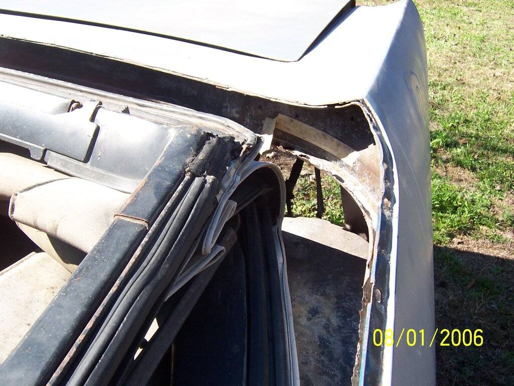

The trough that runs along the back edge of the dutch panel is easily over run with water if dosed with a hose or put through the car wash. Not to mention that they are made from untreated metal, they will perforate over the years, especially where the roof edge is basically bolted to the dutch panel. You may be able to see generally where the water is seeping in from inside the trunk, but you may have to remove the roof along that edge and re-seal the area. At the ends of the trough there are supposed to be plastic "directionals" that guide the water into the rear side panels. I've seen pictures of them, so I know they exist, but not on my car. The plastic wrap that is almost always removed by the first mechanic that has to adjust the rear quarter windows is also an essential part of keeping the splashing water out onto the rear seat area, and of course clogged drain holes will just collect and dump water onto the rear floor.
no drains. the rear curtain ( the part that the rear window is attached to) extends 3/4 of the way across the back. look at it from the inside and you'll see what i mean. unless there is a hurricane or someone gets crazy with a hose there is no reason for it to leak. the channel itself is about 1 1/2 across by 1 inch deep with a lip that curls to the inside of the channel. i think it would be fairly easy to overwhelm the channel with water causing it to spill over and run into the trunk especially if the top wasn't trimmed well and lays in the channel. make sure that the plastic chutes are attached well to the ends of the channel. mine were kind of loose and flopping around.

So where does the water go after it exits the 'chute"?
It is supposed to drain out through openings (almost always clogged) in the rocker panel in front of the rear wheels. Meanwhile it is splashing on all of the exposed metal parts of the window mechanism and onto the cardboard of the rear side panels, unless that plastic sheeting is still in place. These cars were not designed to get wet.
As you can see, mine have pretty much decayed and will have to be replaced. I will be examining this closer and see if it could be re-engineered to work better, but I think the best bet is to simply avoid water.
