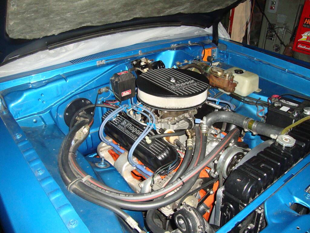

man you don't have to go through all that , we used duracool torch lamp fuel , its half the head pressure and less apt'd to seep out , its been 4-5 years in two a/c cars i've done . still 52 degs out the vents . here is the duster . the other was a 69 rivy with a cad engine and gm compressor . no issues

man you don't have to go through all that , we used duracool torch lamp fuel , its half the head pressure and less apt'd to seep out , its been 4-5 years in two a/c cars i've done . still 52 degs out the vents . here is the duster . the other was a 69 rivy with a cad engine and gm compressor . no issues View attachment 467245

maybe you are just looking at the duster , that was just one i've converted , it works just as well in stock units as well . i don't have pics of the rivy with its factory compressor those big heavy long gm units . point is no need to change the parts just to fill your a/c units with 134r crap or that costly 12r . a12 is better refrigerant with a lower head pressure about half head pressure that both 12r or 134r . in fact duracool has a whole line of products to recharge or for those first time charges . i'll never use anything else .
Is Duracool flammable? Why doesn't everyone use it? Does it affect the ozone layer? Vehicle manufacturers have to consider such questions legally.
yes its flammable , its used as a torch fuel . its mainly butane . but gasoline is flammable to right . and carb's vent to the air , the a/c is a closed loop .
