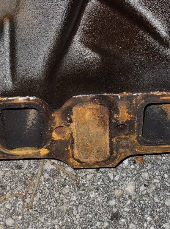

Hi guys, I just completed an intake manifold swap on my 66 Polara with a 318 Poly. The purpose was to go from a 2-BBL to a 4-BBL carb. I just ran the engine to tune the carburetor and checked the oil afterwards. The oil was brown and tasted of coolant. I have some questions, but first a little more background.
1. Before removing the old manifold, I took off the water pump (to replace it). Rad was drained too.
2. The intake manifolds (both the old and the new) have one set of what I presume to be water passages blocked (see picture).
3. When I put the new gaskets on I followed directions to put plenty of sealant around the ACTIVE water passages (on both the block and the manifold.
4. I did not put any sealant around the BLOCKED water passages.
5. When I reassembled everything, I had a huge water leak from water pump. I had to remove water pump again clean both surfaces, put a new gasket on and put plenty of sealant as dressing on both the timing cover and the water pump. I had no leaks afterwards.
So here's the questions:
Could the source of the coolant in the oil be contamination from when I removed the intake manifold? I didn't see any coolant when I removed it (remember I had removed water pump and drained rad).
Obviously water doesn't flow down the blocked passages on the manifold into the heads but now it occurs to me that water circulating around the heads might flow UP to the blocked manifold passages (with some pressure). Could the fact that I didn't put sealer around the blocked passages mean that water is leaking there?
My plan is to change the oil and filter tomorrow. Hoping I didn't do any damage and hoping it was just some contamination from manifold removal.
Photo of old 2-Barrel intake manifold. The "new" one also has these rear water passages blocked.

Coolant water mixture from the heads still contacts the blocked passage, so yes, it should have been sealed both sides.
Pressure tester on radiator and quiet garage may give you a hiss at the area of the leak, once you pump the cooling system up to 15 psi.

Wouldn't the combustion be compromised if water was escaping through the unsealed gasket on the blocked passages?

Not necessarily. It might be vaporized and sent out the exhaust pipe.
Also, gravity might dictate that coolant/water is draining onto the intake valley and down into the oil pan.
If the oil did not have coolant in it before the intake was replaced and it does now, the intake replace is probably the culprit.
Further, sealing the intake bolts if it's a small block is a good idea.

I guess the low friction thing to do would be to change the oil and filter and see what happens, understanding that I probably have to remove and reinstall the manifold. FACK.

You should have sealed up those blocked passages, there is still coolant there amd the gasket is what seals it.
Maybe the manifold is cracked? Or been milled down? It is about 60 years old. Did you install the manifold dry and see if it fit on the heads correctly?

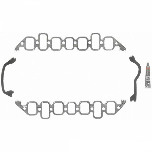

T stat is on the intake, along with bypass hose, heater hose bibs and temp sender. You know, just like an LA engine arrangement.
here is a pic of the gasket. 4 intake ports, 2 water ports, one exh crossover On each side.

I used the sealer that came with the felpro gasket set you posted the picture for. I used the end seals that came with the kit.
Yeah, I realize now that I should have sealed the blocked passages. My flawed logic was that if they were blocked there would be no water passing through them. But I didn't think about water circulating in the heads coming UP to those blocked passages.
I test fit the manifold an all seemed OK. Holes lined up.
Yeah, this is the set I bought from Summit. This is how I installed them. Ok. So obviously, I need to re-do the work. I've made peace with that. Question is have I damaged anything? What to do after I install new gaskets? Change oil several times?

I think if you damaged something, the engine would not run so well.
I would reinstall the intake, change the oil, see if you still taste/smell coolant. If not, you're probably good to go. You can keep checking the oil to be sure. Also, a cooling system pressure test that shows no leak is a big relief for a mind that's been dealing with the same problem for a long time.

I reinstalled the intake and have changed the oil twice. Good to go.
