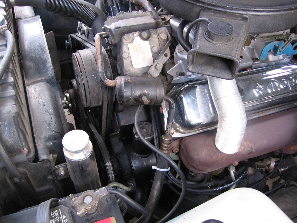

They didn't have them at that time. However, I applaud your desire to install one. I have one mounted on the passenger side, on the engine side, and I just looped the hose around over the top of the shroud. Lots of room there for a coolant recover bucket.
My car is a 66 T&C with dual AC, so it has essentially the same dimensions as your 66 VIP. As you can see, no interference with anything.
By the way, right side and left side of vehicles is determined when sitting in the driver's seat. Therefore, right side is the passenger side on a left hand drive vehicle.

Thanks for the picture, it helps. It was more of a mechanic point of view, poking around in the engine bay. I thought the battery tray would cover me lmao.

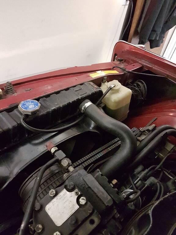

I mounted one at the same location pulled from a 73 Newport
Luckily, the vent overflow tube pointed in the correct direction which keeps things tidier
I put this type on the Newport and the Gremlin. They are available at Hot Rod Shows. Work well!

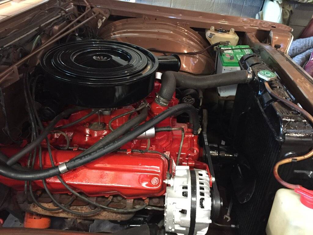

As mentioned these are not original but mine has an add on. Wish I had a better picture but it does give you an idea. If you decide to add one make sure you install the correct style rad cap.
Just an FYI
