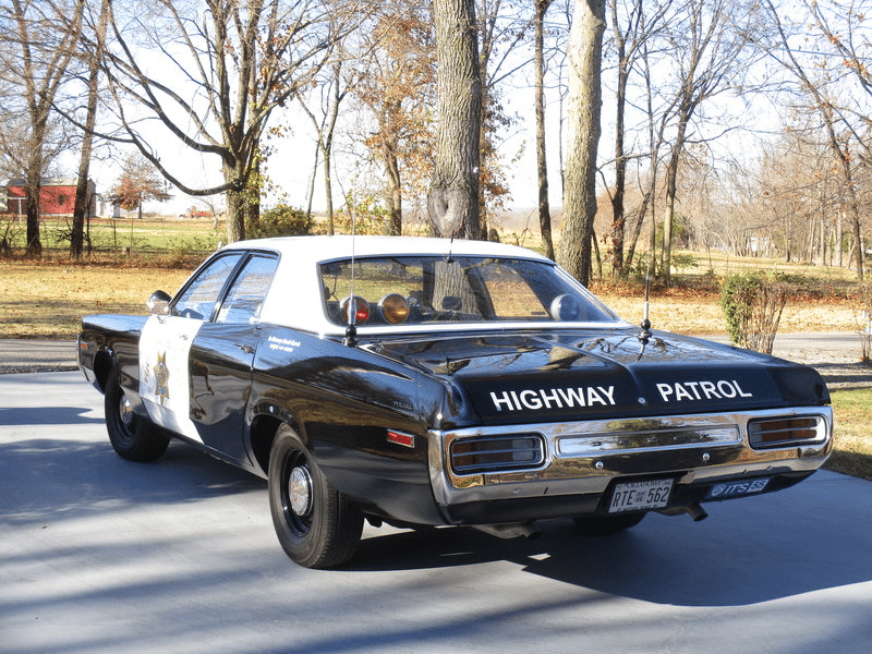

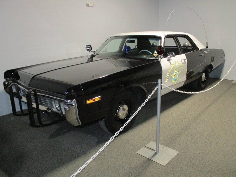

NOT MINE Cop car:
I'll throw up some more pictures of this one.
:thumbsup:

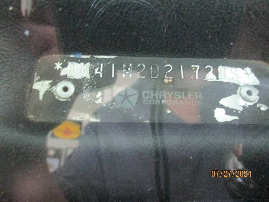

DK41M2D217205

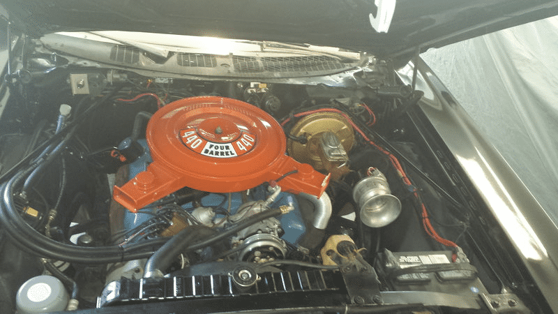

VIN says it's a 400
Well done.
not a player, but if a 440 car now, love to know how it got a 440 (in service or more likely after it was retired). Also is there a CHP paper trail? (vs. a K VIN done in CHP style).
Again any event, nice rig.

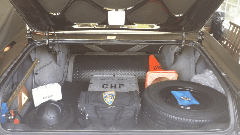

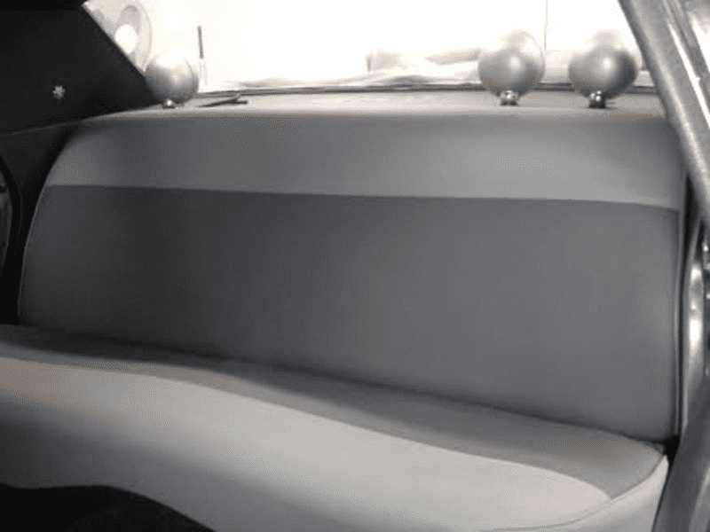

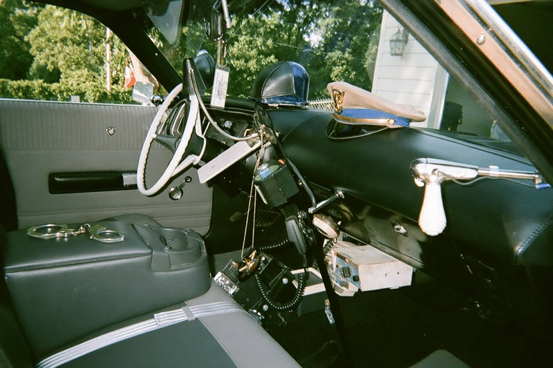

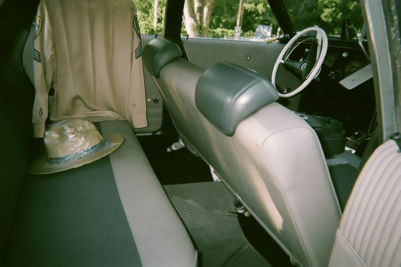

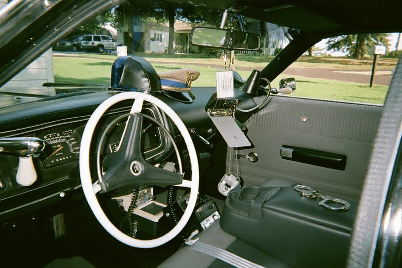

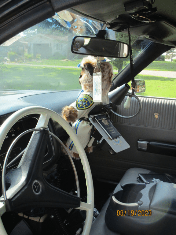

Asked for a pic of the data plate, awaiting that sent these. Do these helps decode its history at all? Thanks
I highly doubt this was ever a CHP car.
I know in 69 even the unmarked cars still had the 440
This was originally a white car.
It looks like a non-AC car with add-on AC, not CHP, all cars starting in 69 had AC.
Plus many restoration errors.

dare i say then, a well done "clone".
to the extent they didnt "get it right" is beyond my expertise as I have never done/owned a CHP sled. :)
that said its "ask" suggests "real" CHP .. surely all that would get sorted before a transaction is completed.
hope it does well in any event.
The M code is for a standard duty 400 2 bbl, not the HP P code 400 you would expect. It could be a detective car or personal car for an official but almost certainly not a patrol vehicle. Would be interesting to see the rest of the build or fender tag, if it actually had the A38 package at all
Description:
1972 Dodge Polara found in Oakland, Cal.
Clear good Oklahoma Title. Transported to
Oklahoma and restored to Black/White w/all
markings, 2 sirens, PA, Grill lights,
package tray rear CHP lights, Black
spotlights - red and clear,
CB radio, LED grill lights, motion detector
that plays hidden stereo "BAD BOYS theme" on
grill speaker, new CHP interior, all
mechanics new/updated, great running engine,
low miles, museum quality (was in a museum 6
yrs), + more. Some CHP items included.
