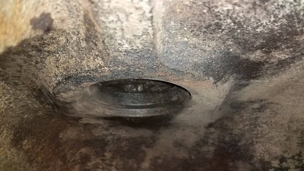

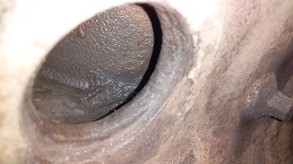

Thanks for the replies , some good info there .
I will post some photos of the lip in the block and where one hole has some of the lip gone .
On various Slant/6's i have had over the years i have always installed the cup style plugs with the lip outwards as they didn't have a lip inside the plug hole .
On the 361 , because one of the plug hole lips is missing a bit i am probably going to have to use a cup style plug with a short lip and no curve in it so it can be installed with the lip outwards .
Then it can seal on the lip in the block .
Some photos of what i am talking about .

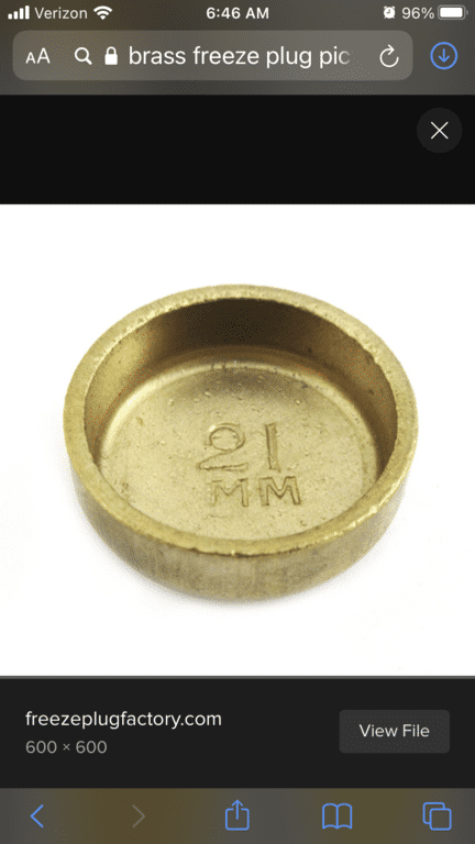

First thought on your engine pictures is that is one of the cleanest blocks that I’ve seen. You are blessed!
I think that you may be best off installing the second picture type after scuffing up the block’s mating surface with crokus cloth. If you feel the need for a sealant, use the Indian Head Shellac.
