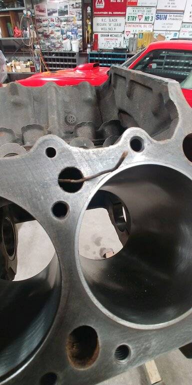

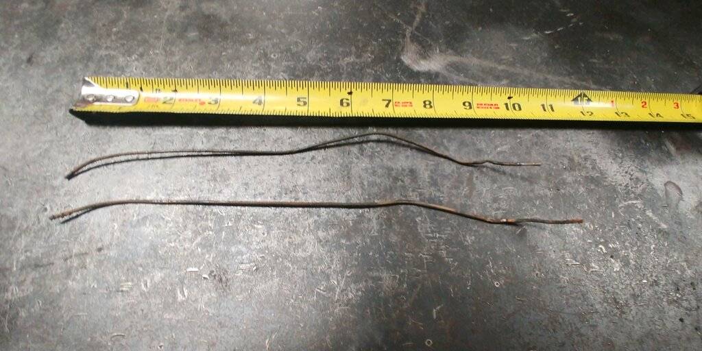

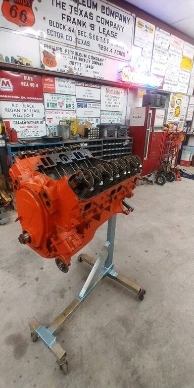

I will be installing my 383 back in 66 sport fury soon and wanting best advice on firing up emgine and follow up procedure. I discovered mopar’s oil drainback to pan is slower than the pumps ability to empty the pan and spun rod bearing at long distance high speed/rpm blast. Had to bore 0.040 turn crank, replace 1 rod and discovered #7 cyl was previusly sleeved. And 2 pieces of coat hangar wire in water jacket of block. C

I can't think of any good reason for the coat hanger wire in a coolant passage. I have seen it done on some old flat head six engines in the oil passages to the cam bearings to improve oil flow to the rods and mains. A lot of the older flat head engines had poured cam bearings that were expensive to recast, so the wire became a short cut for some low quality rebuiders on engines with worn cam bearings.

I think you will find that the wire is not "coat hanger" but rather stiffener wire for the sand core when block was poured....

Personally, I tend to concur with that statement. Can't understand why somebody would take the time and EFFORT to put coat hanger wire in a water jacket, for any reason. BTAIM

That wire could certainly be from casting the block.

I also had the wire in my water jacket when I went to do my rebuild.

The 383 crank was 10 - 10 and bored .030 but someone old school ridge reamed couple cylinder so they were funnel shaped. And piston at tdc was .080 down hole.
