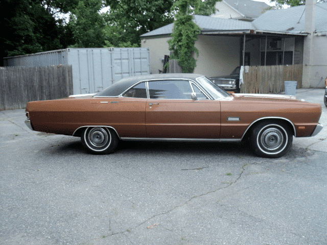

  13. pentacar
    pentacar Member
    Messages:
    84
    Likes Received:
    102
    Joined:
    Aug 10, 2012
    how about this, sport fury, orig. paint & interior, only 18k miles, 383 2bbl, excellent shape, stored indoors most of its untitled.png life let know if your interested, thinking about thinning the herd
    • Like Like x 3
    • Thanks! Thanks! x 1

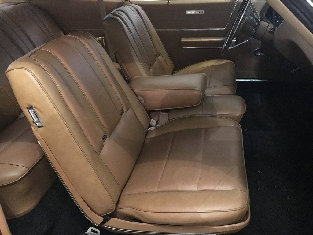

  14. Ironwolf
    Ironwolf Senior Member
    Messages:
    3,648
    Likes Received:
    1992
    Joined:
    Sep 25, 2013
    Location:
    Massachusetts
    Nice looking Sport Fury.... What color interior ??? (just curious and not a player for it)
  15. pentacar
    pentacar Member
    Messages:
    84
    Likes Received:
    102
    Joined:
    Aug 10, 2012
    previous owner bought it off the estate of the original owner, top is tan with tan carpet and like a saddle color interior, he painted the top black and put a black carpet in it, i'm in the process of changing it back.

  17. Ironwolf
    Messages:
    3,648
    Likes Received:
    1992
    Joined:
    Sep 25, 2013
    Location:
    Massachusetts
    If possible could you please post some pictures of the interior
