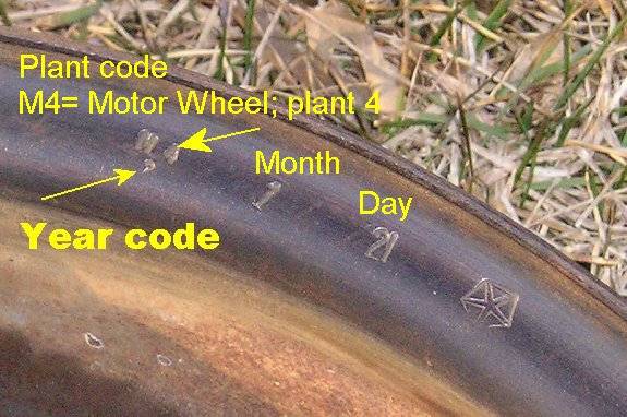

Plant year and specs stamping.
presuming from previous experience.....
K2. Kelsey Hayes plant 2
4 calendar year 64? 74?
April date code?
M and F .....don’t know. Likely wheel width designation or load rating.
Are there more markings inside of the rim?
For "M" and "F", possibly inspection stamps for various parameters, where a normal paint daub would not do? "Stamps" rather than daubs, considering the somewhat temporary nature of paint and the high importance of wheels to vehicle safety?
Just some thoughts,
April date code?
