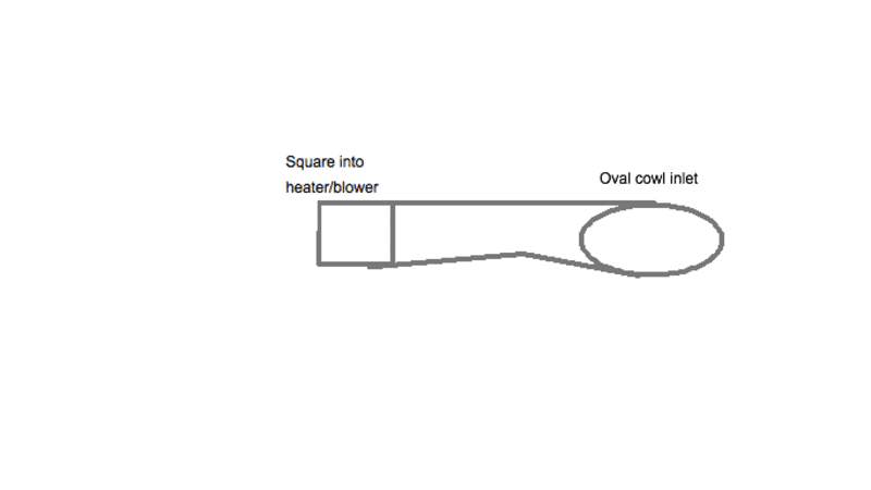

Since I usually make things more complicated than they have to be: I'd like to have it sloped or with a drain in the bottom to avoid standing water. Much like my crudely drawn diagram below :wideyed::):D:eek:

Square to round transitions exist in the HVAC world. They can be fabricated of metal and big HVAC companies (and some supply houses) have plasma cutters and the software to make about anything.
Can you post a pic of what it really looks like. In the aviation world, we use High Speed Tape, which can be formed into just about anything. It's also used on race cars... light-weight and durable.
It might be what you need, if I can get a better look at what you are looking to make. The hand drawn picture doesn't really help much, and I'm not all that familiar with the part.
=== nevermind. I'm sure it's what you need. Make the oval out of aluminum, rivet it together. Use the HST on the end to form the area on the box. done. It's literally what they did in the Apollo 13 dilemma.. except they used duct tape.
