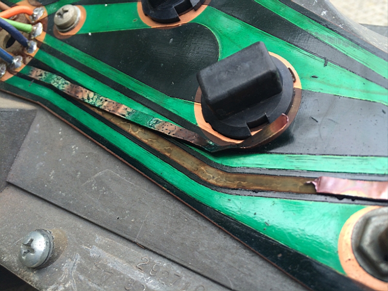

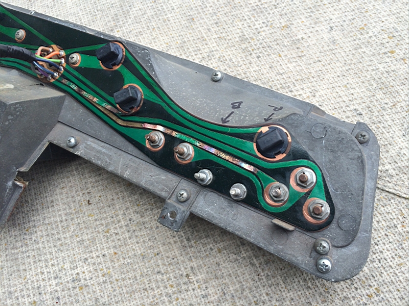

My friend leaves and I proceed to pull the cluster. I swap the gauge with another I had and put the cluster back in and hook the battery back up. As soon as I turn the key on I get sparks from under the dash, I turn the key off and disconnect the battery. A quick look inside and see no sign of fire I step away and take a break. Flashlight in hand i start looking through the switch panel and radio openings and see nothing obvious, stick my head up from the bottom, nothing.
So i pull the cluster figuring I'd have a better look with it out, soon as I pulled it out enough to disconnect the wires I saw the problem...
After looking over the wiring diagrams I speculate I had a dead short in the 2nd fuel gauge. I have several more boards and a couple more gauges so I should be good to go. I did inspect the harness under the dash and didn't see any problems. The plan is to replace the gauge and board and try again.
