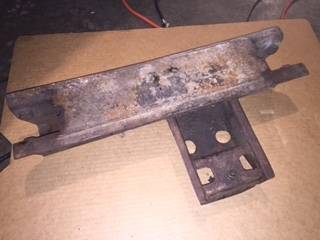

Sorry, a little too much eggnog and bourbon when I posted that.
I managed to find the part. Can anyone ID what year it's from? 68?
Thanks
Pat
That looks like the original one I took out of my 65 Fury but I believe it could be other years as well. I am uncertain when they started using the newer style trans mounts.
