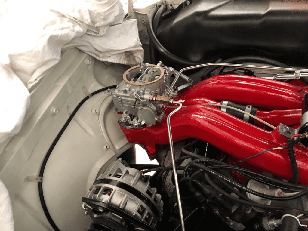

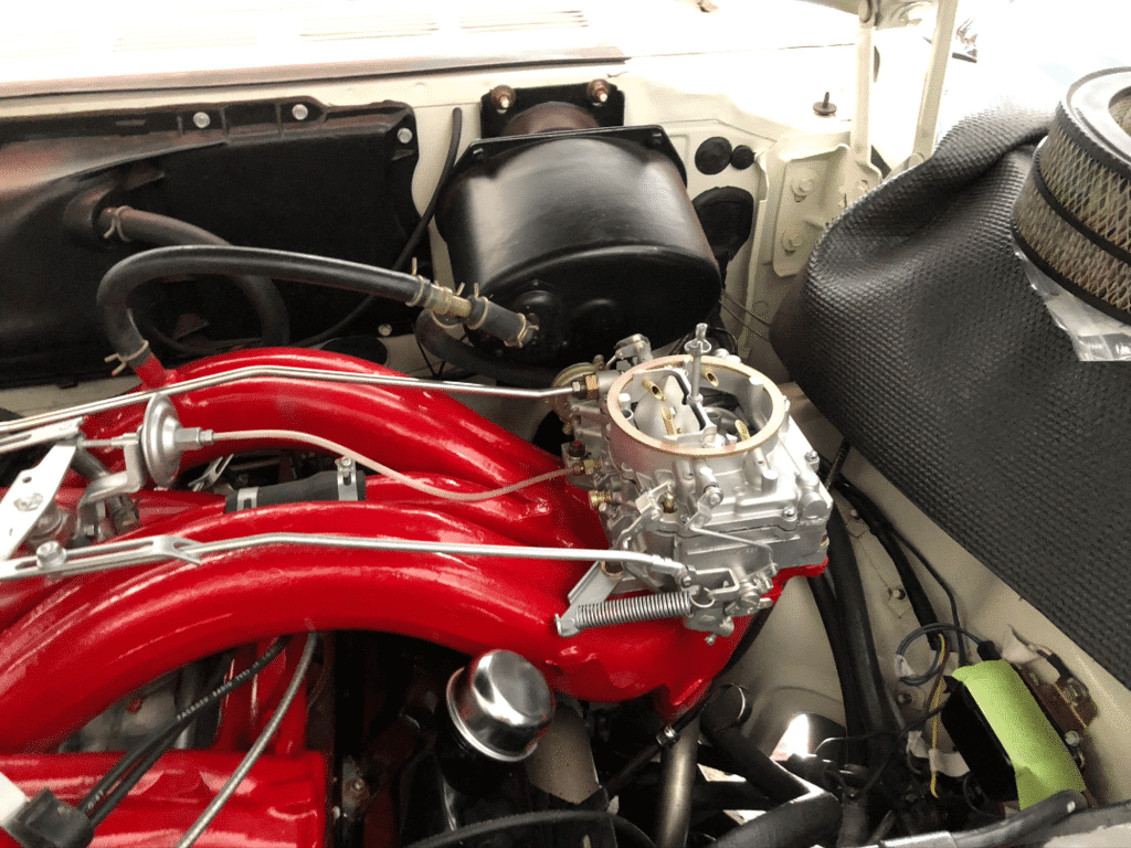

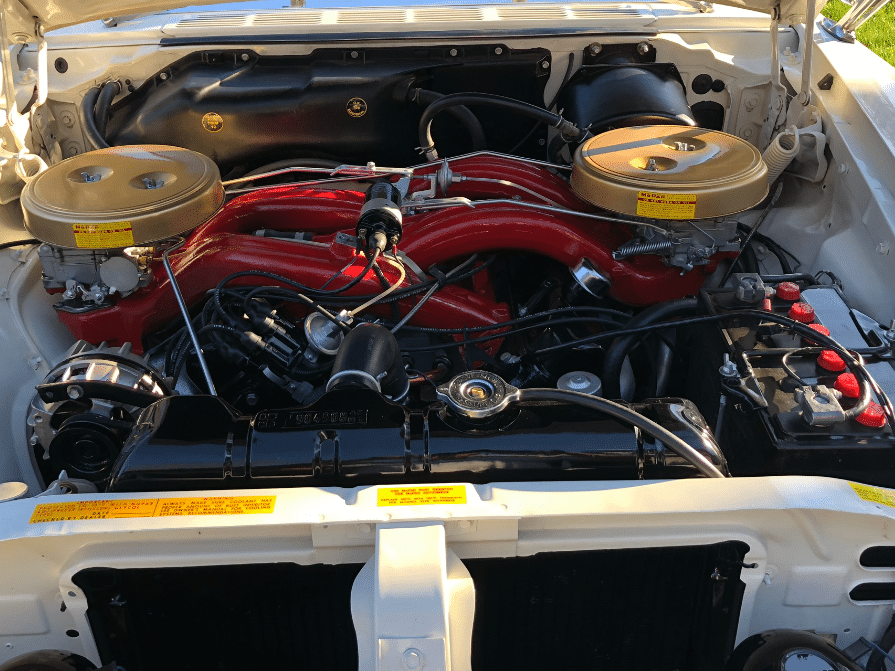

Howdy! Here are some photos of my '61 300G with its factory 413 cross rams . These cars are fast, big on torque! Carbs are factory CARTER AFB 2903S and these were rebuilt to show quality two months ago. These are identical carbs. They are adjusted per FSM 300G addendum. There's no problem with the car and its drivability but it is a pig, about 7mpg around town. I had a 300F, same set up and same mpg's. You don't drive these with gas mileage in mind! Hope this helps! bob

Nice car Bob. You even have the one year only correct alternator!

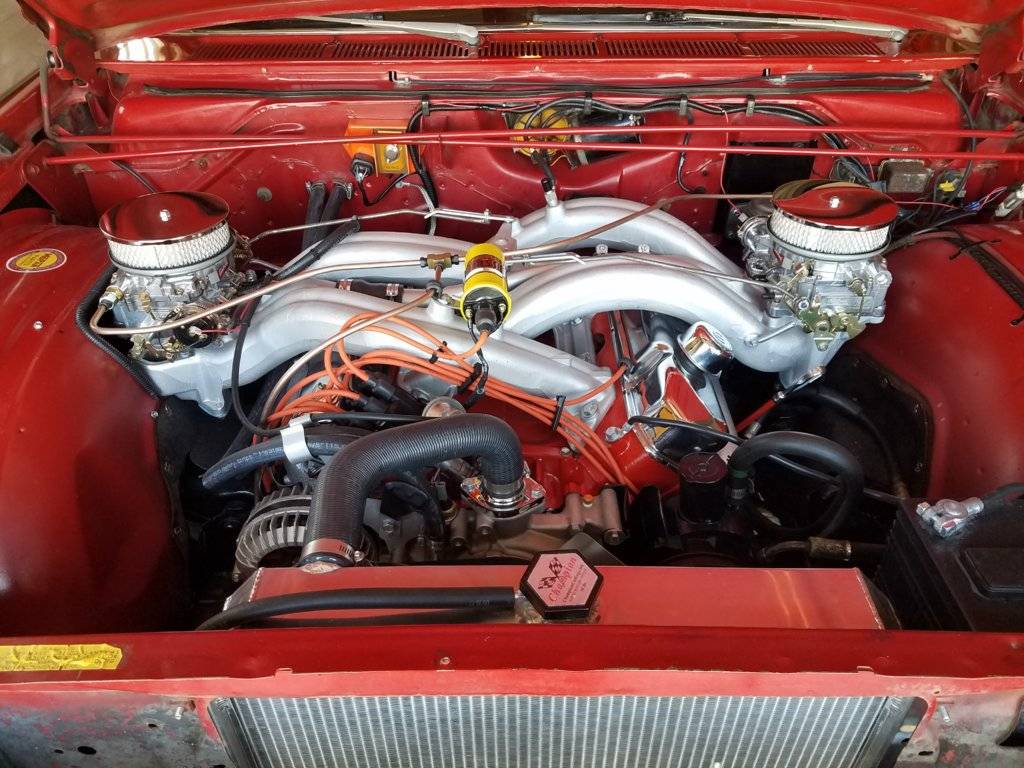

You have a '65 right? If so, there is a member here ( I can't remember who right off ) that has a cross ram set up on a '65 or 66. If I remember right he had to cut/notch his fender wells for it to fit.

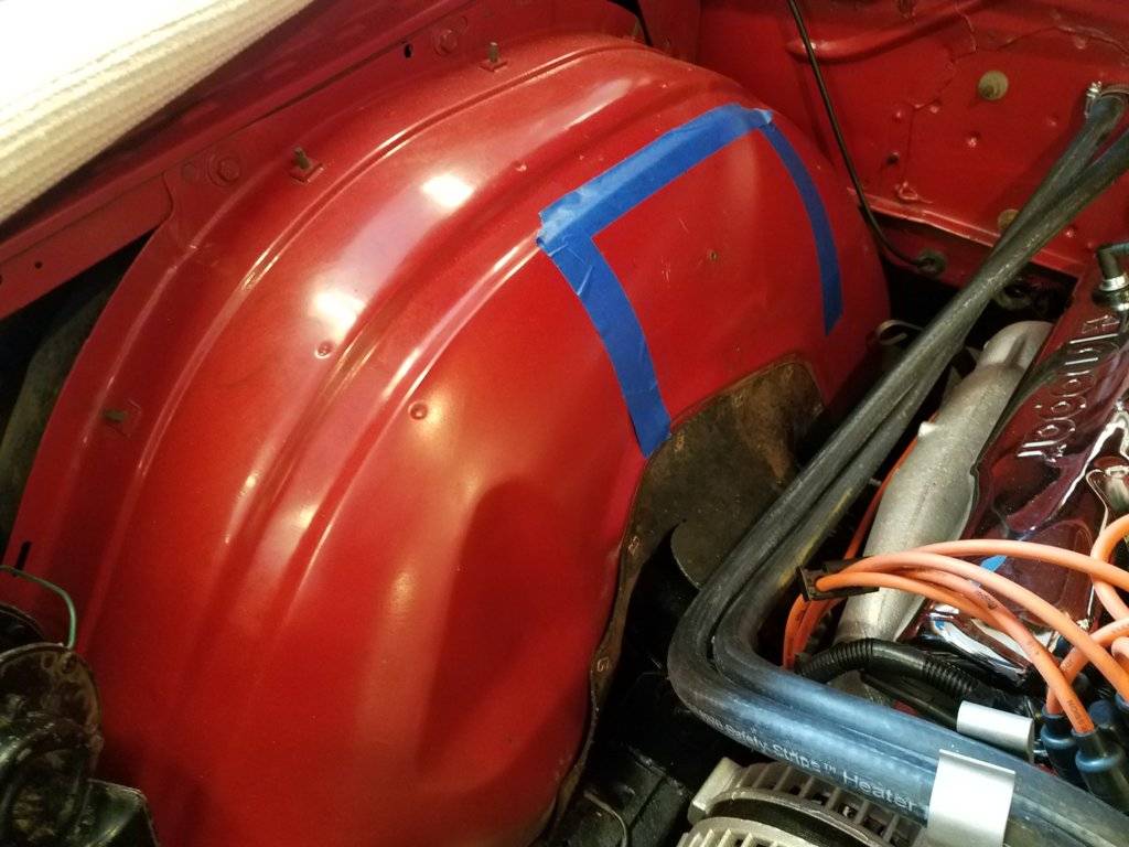

As LocuMob indicated, my '66 Newport has a ram induction set up on it and I had to notch the right inner fender for clearance. The other issue was brakes. The intake on the left side doesn't provide clearance for a dual master cylinder or booster. I have a single pot non assisted master cylinder on it. Not at all confidence inspiring! I am going to take the rams off, as much as I love the way it runs and the cool factor. And go with a single 4bbl and do the brakes. I did retain the part I removed, but think I'll replace the inner fender ( I bought another one before I started cutting).
The last picture, showing the opening was before I finished it off. I built a "box" to provide weather protection and sealed it up to the backside of the fenderwell.
If you find a set for sale be sure to check the choke pits as they were famous for rotting out. When that happens, the automatic chokes stop working. There are fender well cutouts on most cross ram applications. The brake booster setup was also different starting in '63 Mopar used a master cylinder mounted to the firewall and a remote booster mounted to the driver side fender well, cross rams were dropped for the '65 model year.

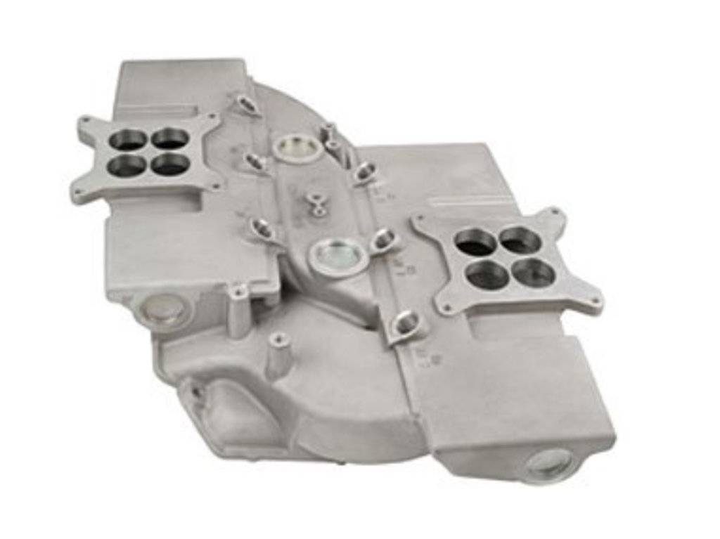

Let’s all get on the same page with the terminology.
Those beautiful intakes pictured above are called Long Rams. They came on 1960 and 1961 361 and 383 Dodge and Plymouth’s, and 413 Chrysler 300’s. The 361/383 and 413 intakes are identical with the same part numbers.
below is a picture of a cross ram intake, it is one piece and just like any one piece intake the pay are different for 383 and 413, or B and RB engines.
for those that want to say this is anal. No, this is correctly identifying what we are talking about. Thanks!
Also keep in mid that 383 cross rams do not fit on a 413. If you find a set for sale be sure to check the choke pits as they were famous for rotting out. When that happens, the automatic chokes stop working. There are fender well cutouts on most cross ram applications. The brake booster setup was also different starting in '63 Mopar used a master cylinder mounted to the firewall and a remote booster mounted to the driver side fender well, cross rams were dropped for the '65 model year.
