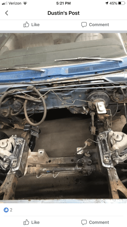

In a Fury. Any advantages to doing this?
Ford suspension, Chev engine in a Mopar. What could possibly go wrong?

Rack and pinion would be an upgrade. To some getting rid of the big steering box and t bars has advantages. That would have made the turbos on mine easier and probably handle a lot better. Substantial work tho
Some people don't like eccentric-washer alignment adjustment set-ups. Preferring GM-style SHIMS instead. Seems like the CV upper control arms are two-piece, with a serrated interface where the camber adjustments are done?
And then there's the orientation that T-bars are ALWAYS in the way, not understanding how their mountings and such spread the suspension forces out over a broader area of the car. Whereas on a coil spring car, it's all centered in the crossmember area.
There goes all your ability to fine tune the ride height plus you've turned it into a front-steer system which will severely affect handling. If you don't like the stance, you'll have to buy new springs instead of adjusting the torsion bar bolt. Those little stubby A-frames look like they belong on a Mustang II or a Pinto.
C bodies work best with rear steer, not an aftermarket adaptation of a FoMoCo system.
