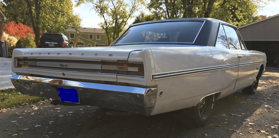

This isn't really modified/customized to an extent you are lookign for, but perhaps it'll get things started.
Modified with a (66-67?) B-body rearend, springs moved inward via the old MP offset shackle/front eye bracket kit, and 15x8 Ramcharger wheels (4" backspace).
275/60-15 tires tuck nicely with zero rubbing on the skirts.
295/50 would not fit with the skirts, which suited me fine because the huge dia looked like Tonka wheels.
Aside from lots of measuring and drilling of some holes, it all dropped right in like it belonged there.
These wide tires make the car fit the old adage 'it's not fast, it's quick'.
Also has 4 bucket seats from a mid-80s Mazda 626, the headrests on the rear seats are hiding in the shadows (and are easily removable).
