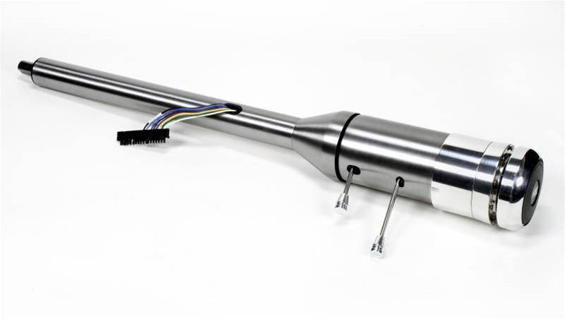

Has anyone had a custom steering column put in their 67-68 Chrysler or c body's? I'm looking to do this but I cant find one for a c body. Any help is appreciated.
You mean an aftermarket steering column from a company such as Ididit or Flaming River? Would be similar to doing an installation on a street rod, just a different vehicle, in theory. Would probably need to cross the (typically GM) wiring harness color codes into the Chrysler coding where everything connects. Would most probably be best with a floor shifter, too!

Im putting it in a 67 300 floor shift. I have a factory tilt wheel I will sell if I can get what I'm looking for. I'll call Ididit today. I see summit advertises one for Mopars but it says it works for all the body styles. I don't know how that works. Do the have extensions, adapters for the extra length? That's what I need to know. I just figured someone had already done this and would chime in.
Thanks for the help.
Ididit and FR do make some model-specific tilt columns, but usually for more popular applications as Camaros, 55 Chevies, and similar. Otherwise, it's a "measure" situation for their universal units. If you have not already done so, you probably need to go into their website and look around. While you're at is, I might recommend that (under-dash space available) to also onsider an upgrade to one of the electric power steering columns.

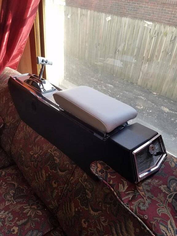

I have no issues with my current column. It needs a turn signal switch replaced is all. I'm building a semi Pro street 67 300 with a 68 300 front end and side chrome. I have a 542 for it low gears in trans and GV OD. I have customized the console a bit with an armreast from a dodge and added a Hurst Pro-matic shifter and wanted a new sharp steering column to compliment to look. New electric steering columns?
This is what I'm leaning towards. After speaking with them at Ididit the conclusion is the 33.25" column I will have to use my upper and lower mounts with the column. They said just get the column through the firewall 2" no more if possible. Then it's just a matter of 2 ujoints and a custom length splined shaft. He said that was the easiest part. FYI. The factory column is 2.25" Tube going through the firewall. Make sure you don't get a 2" column which is common. This column starts the steeringwheel bolting 2" closer to the driver. So a 2" dish wheel will put it in the same place as a factory wheel when both are all the way in. The factory wheel has a 3 to 4" dish. I will post pics when it's done with an update. Thanks for the help!
