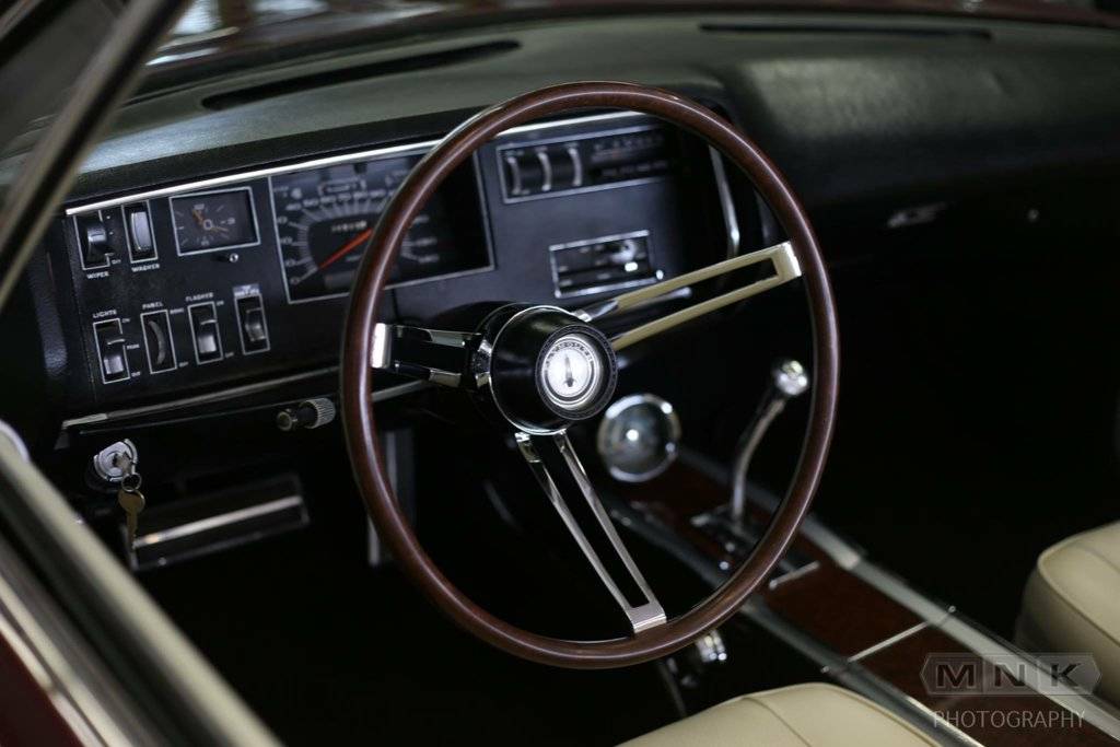

Almost all of the aftermarket wheels will be "flat". The factory "deep dish" steering wheels started with Ford in about 1955, as a part of their "Lifeguard Design" safety orientation of steering wheels and padded instrument panels. The deep dish is supposed to catch the driver in the event of a sudden, unrestrained deceleration, OF the displacement of the steering column toward the driver. It's more than just a fancy way to build a steering wheel! In a time when seat belts were optional, rather than standard, too.
In order to keep the turn signal stalk and shift lever near the driver's hands, they were angled out to match the steering wheel "grip" location. Which makes a "flat" wheel have the problems you noted. The Chrysler "Tuff" wheel option, circa 1970 might have a little offset, but would still be pretty much "flat". Repros and Grant look-alikes are available. BUT there might be some factory/repro items to space it out better. Only thing is that the rear diameter of that wheel might not be the same as your existing factory wheel.

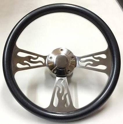

I'm looking for a custom look, flashy. Not factory fyi. It's a forever sharp flame steering wheel.
Like this?

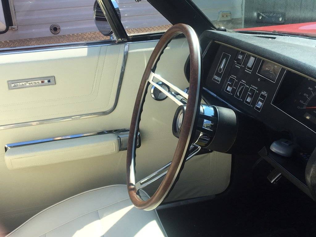

I have a different set of priorities... and problems... I've just finished my Grailing journey of many years by acquiring a nice UNCRACKED T&T Rim Blow wheel, but it's the wrong color...

It's that wheel but a wood handle, not the black plastic in your pic. From my brief experience on this site it seems like if you don't make your car stock looking no one likes it.

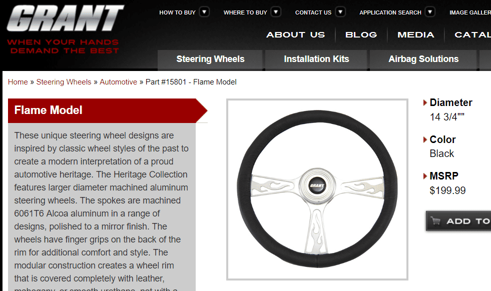

Out of curiosity, I looked at the site that sells the wheels. The spacer is fine, no issue with safety. For you guys wondering, think of the "can" that goes between the wheel and the column on an E body. Same deal. The adapter bolts to the shaft, the spacer bolts to the adapter and then the wheel bolts to the spacer. No issue that I can see.
With that said, getting the correct length spacer is going to be tough. You may be able to call the manufacturer and they might be able to make the right spacer.
Like a lot of stuff out there, some things just aren't made to easily bolt up to a C-body. This is one of the reasons you don't see many aftermarket wheels in C-bodies. You do see wheels like @Welder guy has where it's a transplanted wheel from another Mopar. It just works better with no questions of safety.
