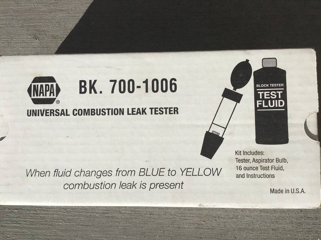

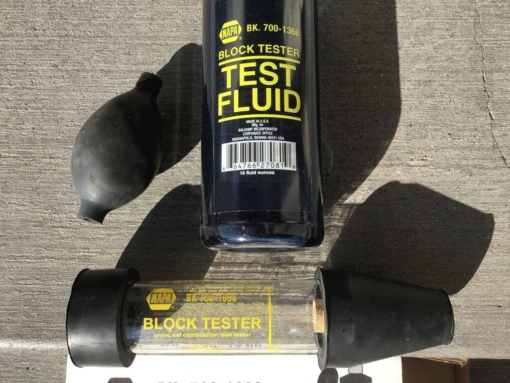

ok i'm late to the party here and havent read any other threads you may have posted about this car...but if you're doing this for an overheating problem get ahold of a head gasket checking kit...the one i use has a squeeze bulb on top and you fill it with a special fluid...with the engine running you put it on the radiator cap hole ...squeezing the bulb pulls in air from the radiator and bubbles it through the fluid ...if combustion gases are present in the cooling system the color of the fluid will change, and you know you have a problem (gasket or something cracked)

I thank you for this thought, but by process of elimination am pretty sure it IS the head gasket on the even numbered side. I suspect the odd numbered head also has a very rusted, crumbling remnant of a steel gasket. We WILL SEE soon enough....

This
