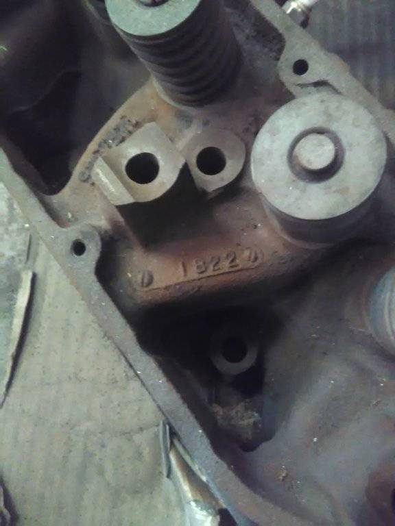

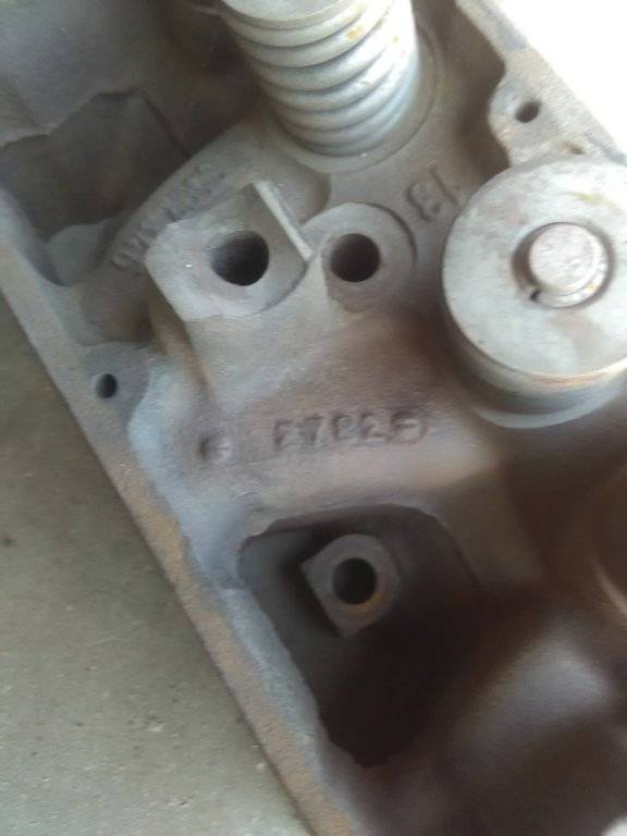

Please forgive my ignorance, I got a pair of used 346 heads for rebuilding my 400. I need to know where is, and how to read, the date codes on these heads. I know in 73, Mother Mopar started using hardened exhaust valve seats in anticipation of upcoming unleaded fuels. I'd like to know if I can just hand lap the valves and run them as-is or if I must take them into a machine shop to have hardened seats installed.
I did take these into a local head shop (the valve spring retainers & keepers on 2 valves was missing) but "technician" on duty either couldn't or wouldn't tell me if they were or not.

Head 1-1822
Head 2-2782
You tell me, when were they made?
182nd day of ‘72 and 272nd day of ‘72.
Only the 452 castings are truly induction hardened. 346 and the others from that time frame only have hardening process maybe .002-3 deep, probably through it already unless ultra low mile heads.
My personal opinion is I would not have hard seats put in unless you are going to run killer valve springs or really high mileage.

I believe the date code reads 1-365, last digit is the year. I'm not good with numbers so don't take my words as gospel on that.
346 heads are "smog" heads with a flatter intake port but do not have hardened valve seats.
