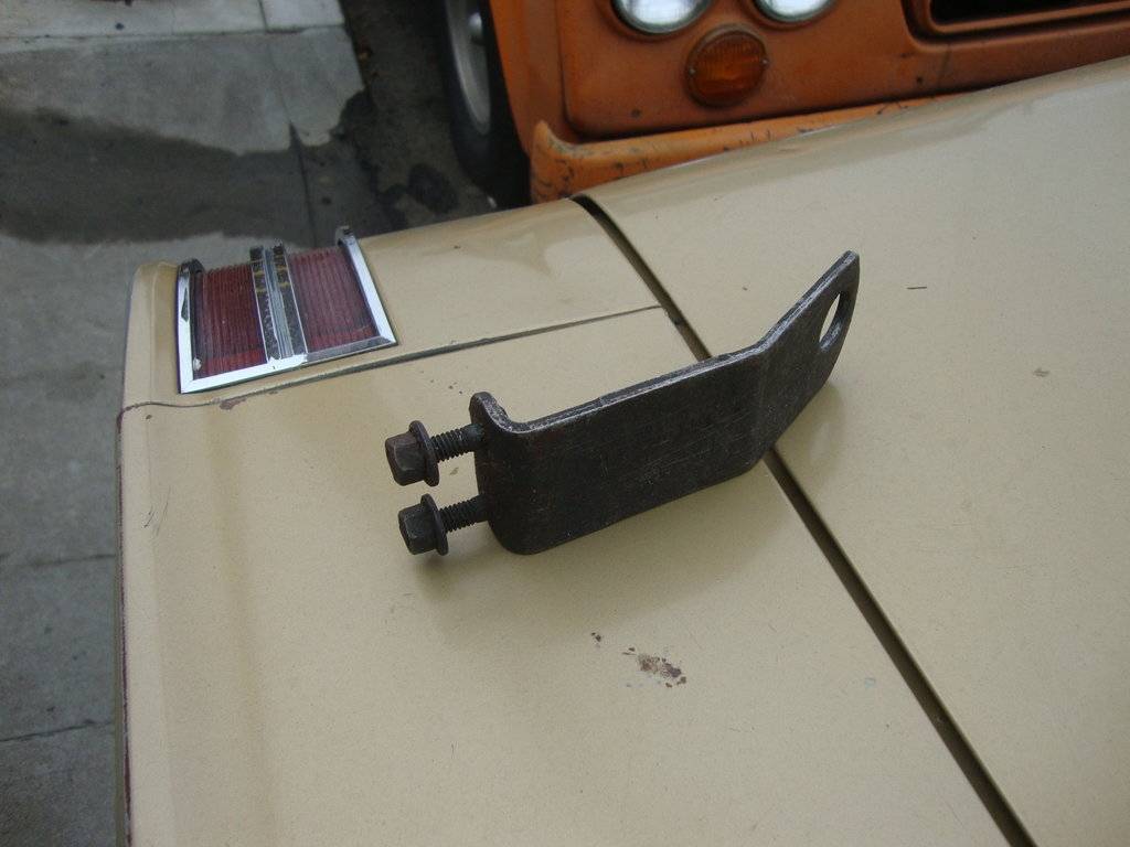

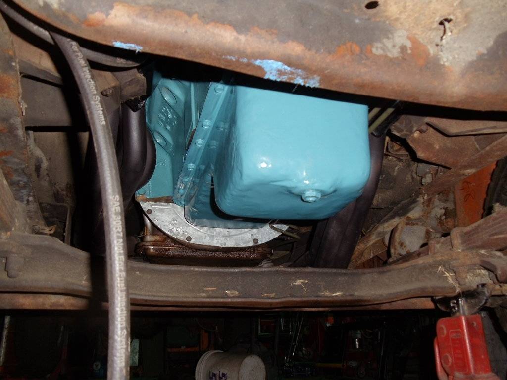

should not be any real issues , change the oil pan for your car and block brackets from the car . i'm trade you a car pan for that for the truck pan . and just need the trans tall stock to have the mount bosses on it for the floor shifter bracket mount in the car . just did the reverse , from the c body to the truck . there is the truck pan , and thats the bracket thats needs the mount on the trans for your car floor shifter . so let me know on the oil pan .
