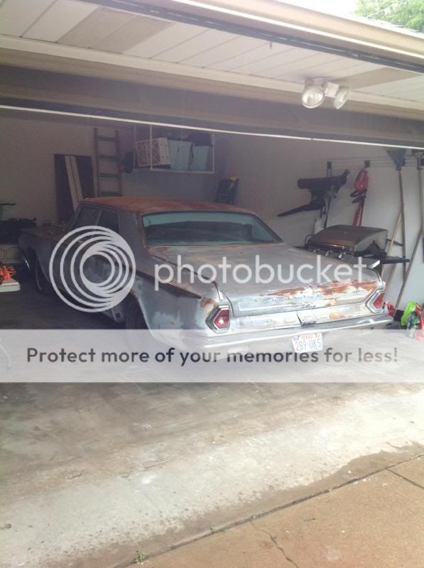

congrats on getting it running! Now pictures?

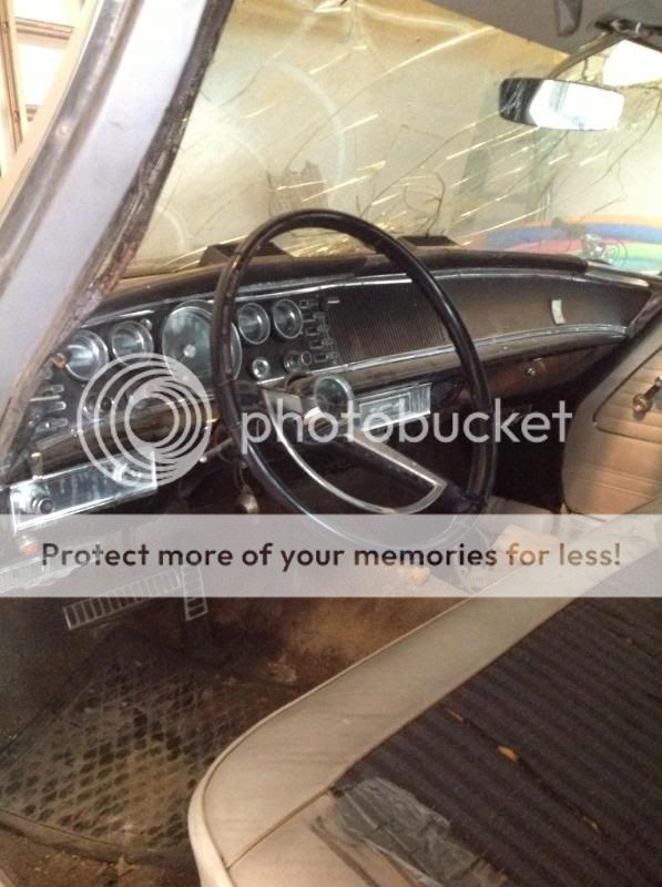

So here are a few pictures. The car is DIRTY!!! I will try to clean it up today if the rain stops. Also will try to drop the gas tank to clean it out. Is there a DIY thread anywhere on the forum? I use the search but it doesn't seem to find any how to threads on any subject.
All right, there she is! Looks like a great project. I'm not really up on cars of this vintage but if you haven't got a factory service manual for it yet you should get yourself one.

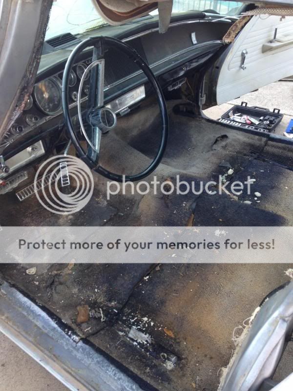

so yesterday, I pulled out the front seats and all of the carpet. I found some rust in the passenger side footwell and the driver side. how do I stop it from getting worse? On the driver side there is a dime sized hole caused by the rust. :angry2: sand it down to the bare metal?
also, what products are good to clean the dash? I was thinking just water and soap...maybe windex?
To clean a dash I use armor all into rot spray and water. I would sandblast out the rust then prime it, that's where my knowlage ends on rust, but its a start
There are several POR (paint over rust) products but to completely remove and replace is truly the best way to deal with rust.
