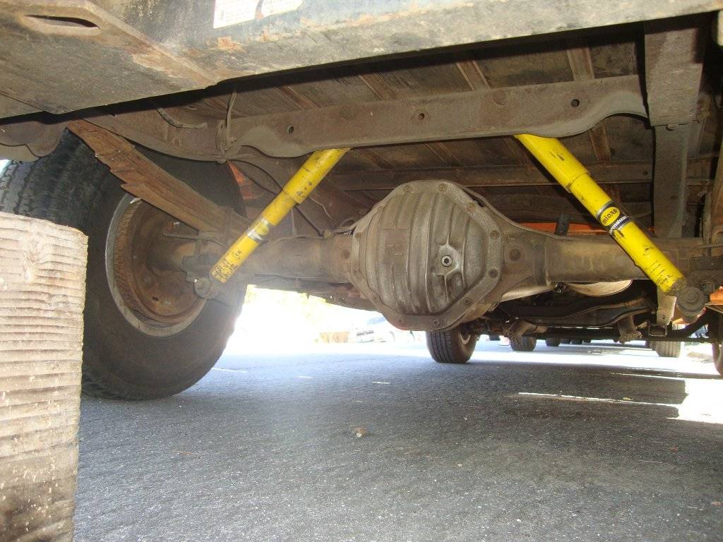

What donor vehicle should i look for a dana 60 to swap into my newyorker?
An E-body Dana is worth big money, do you have one laying around?
If you are really making enough power to warrant moving to a stronger rear, consider a 9" Ford instead of the Dana.
An E body Dana is insane $$$ and you'll probably end up modifying a truck Dana. I'll bet with a little looking around, you'll find a 9" Ford from a full size Ford that will work without having axles made etc.
The earlier 60's and 70' dodge and ford passenger trucks have the lighter Axel tubes. Unlike most motor homes and later Dana's were heavier to support the weight of a heavier load and is overkill for a car of any type.
My understanding is that dodge trucks came with a dana 60 that is inexpensive, plentiful and modify-able for passenger car use. I am just not sure which donor i shoulf be looking for.
All 3/4 and 1 tons from somewhere in the sixties clear to the nineties had Dana 60's. Sometime in the nineties when the Cummins started upping the ante on torque, dodge upped the ante to the Dana 70 and 80's. I don't know about width from truck to c body. But you will have to cut the floating axel housing ends off. There are many suppliers of housing ends that accept 8-3/4 brakes. Depending on how much power you are trying to put to the ground, don't overlook the Chrysler 9-1/4 rear it is said to take quite a beating and was stock in many c bodies. If your not using slicks the 9-1/4 will do just fine IMO
though a 9 1/4 locker from a 75 ramcharger . should be close to your track width , you will need new perches , but 75 chrysler ran them as well , i've got one with disc's on it from a 75 -6 imp . ok with a auto trans . your driveline will need to get longer .
