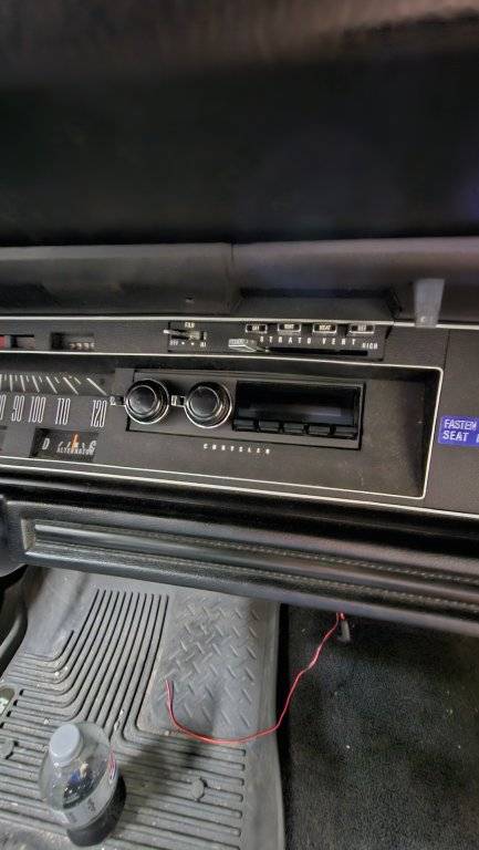

Thanks for the info guys. I removed the ashtray and could get at the radio. I did also have to loosen and move one of the blend door diaphragm to get the OEM radio out. The new radio is much smaller and much easier to get in.
I put a Retro Sound radio for a 73 Charger in the car. They don't list one for the Newport, but both the Charger and Newport have a flat radio, not curved like the Dodge and Plymouth C bodies.
I had to scavenge some parts from the OEM AM radio to make it look and fit as clean as possible, but I was just going to toss the old radio anyway.
