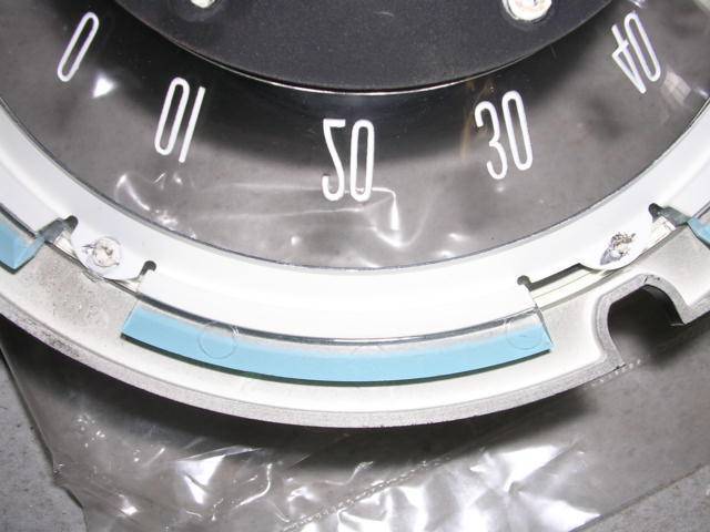

LOL, again the guinea pig. I've managed to overspray the clear plastic. Scratched the clear thinking I could safely remove said overspray. Have made so many templates out of foil, paper, plastic, even a used plastic flower container. Diameter is 6 inches according to my protractor. Don't go by anything I say. losttoo.jpg

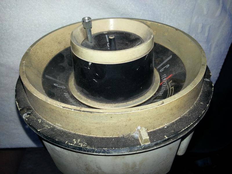

I had one refinished by Scott Smith from Moparts. He did a beautiful job, although it wasn't cheap, but he did a batch of stuff so I don't have a piece by piece breakdown.
Here's a view of the reverse showing the mounting points, I remembered incorrectly, there are 6 points where a stub penetrates from the front through the two back layers and is melted to fuse the assembly and you can see how he reworked them to reassemble after chrome plating.
